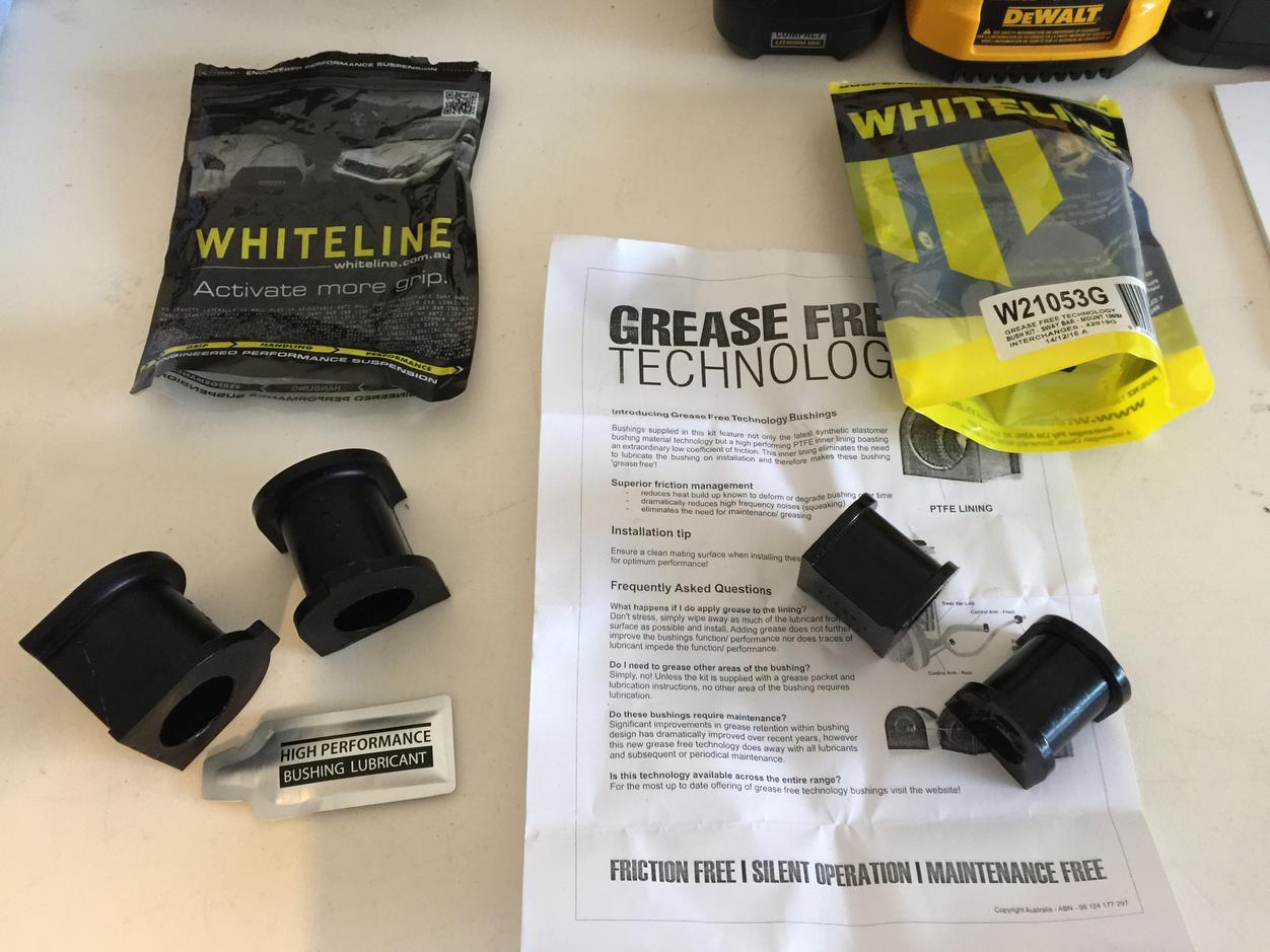

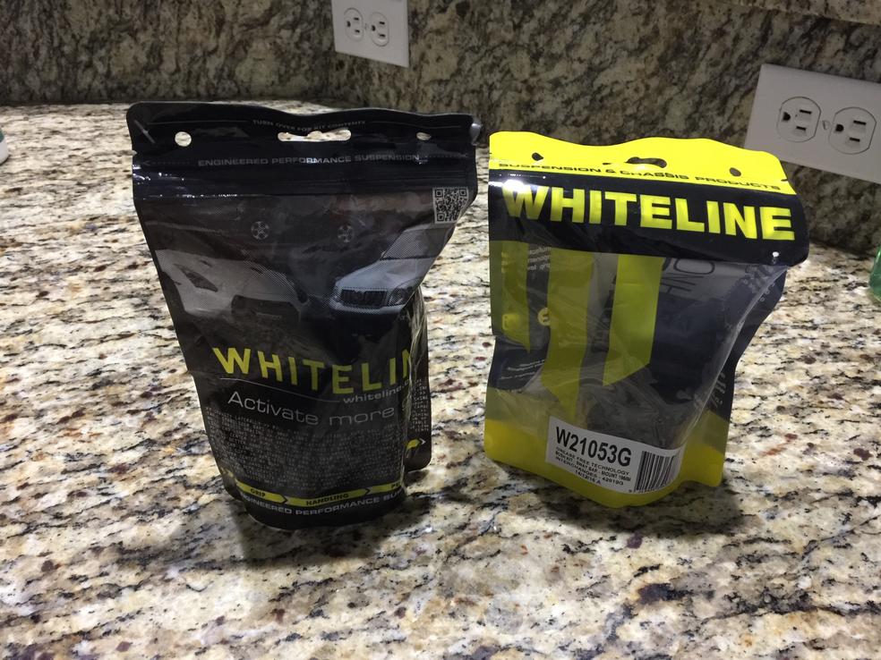

So I installed mine this evening and it was a nice little project. All you need is a 14mm socket, I used both a 3/8 and 1/2 inch drive. As previously mentioned do one at a time, and it's a breeze. Unbolt one front at a time and slide the bushing up the sway bar where it can be removed. Rears are "greaseless" and the fronts got a good coat of the provided black grease. Now for the juice,
The TRD PRO has the softest suspension and I would guess the most body roll. I know it rolls more than the SR5 I had for 2000 miles before the dealer jacked up the paint and bought it back.
After installing all four of these on my PRO I took a ride to the store for some suds. My hood now stays flat around normal neighborhood turns and I was able to catch a hard left through a familiar intersection with WAY less body roll. These made a significant difference in the handling characteristics of my truck and for under $40 shipped it was money well spent.
