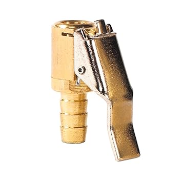

the only thing I would do(and I did) is replace the air chuck. its comes with a screw on style. it works well, and doesn't leak, its just time consuming. a bit if a PITA to thread it on/off each time.
I recommend one of these,
Amazon.com: Tire Air Chuck, Euro Style, 1/4" Barbed End, Open Flow: Automotive
