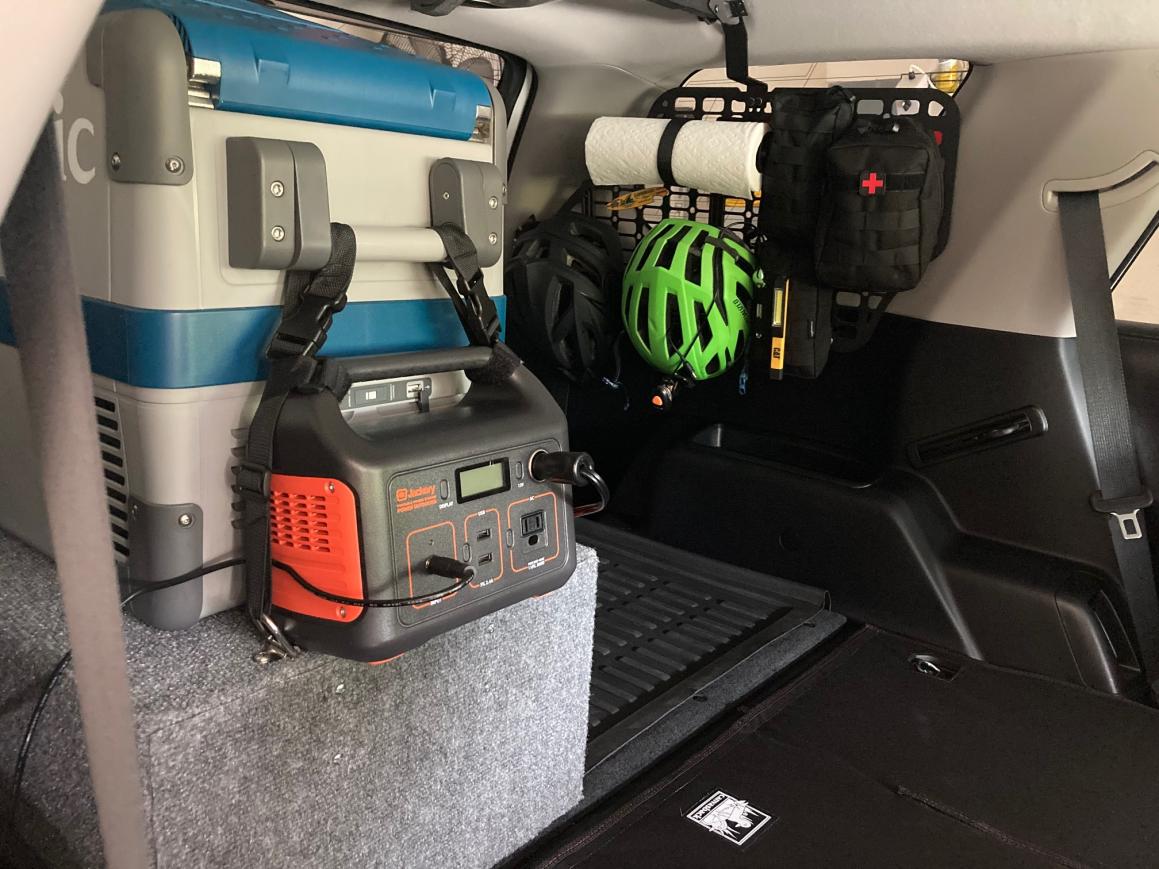

I was wonder how everyone was "mounting" or positioning their power stations. I love the Jackery as a real quick dual battery and solar all in one package but I find it can be awkward to secure.
