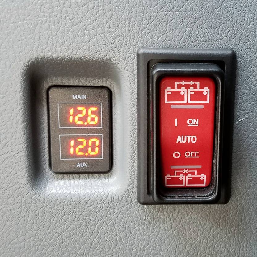

I had zero prior electrical experience... but wired up my own dual battery with charging relay and isolator. Many searches on this forum and others led me to this decision. I have a constant readout on both batteries so I know exactly what is going on and when I need to start the truck to charge. The setup and wiring diagram is linked in my thread on the first page.

Impressive!
