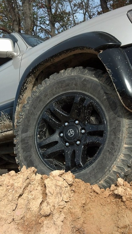

And a picture of my truck just for good measure.
Since the craigslist ad never stated motor type and the silver steelies scream 4cyl I didn't want you to assume anything.
