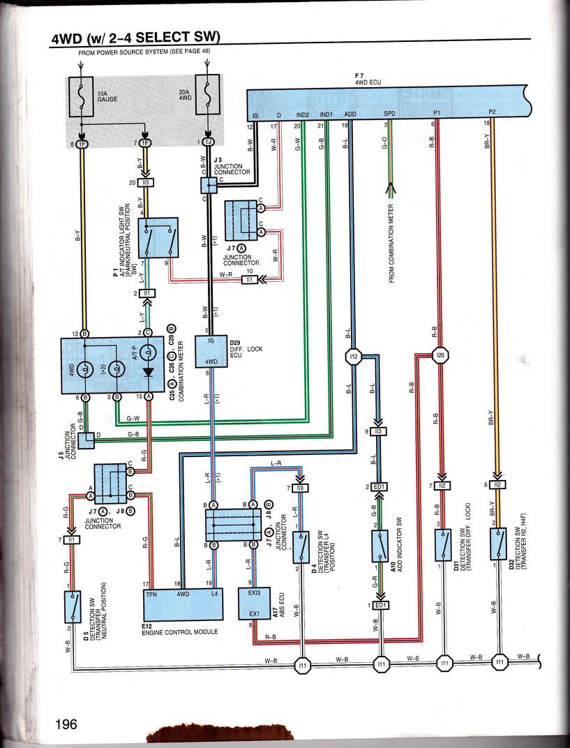

From the factory I have a 96 limited v6. So 5vzfe, an a340f trans and the electronic push button transfer case. Button for 4 hi and push lever forward for neutral and 4 low.
I am installing a new motor, so cab easily use whichever wiring harness would be easier.
I have a complete 98, 5vzfe manual tranny wiring harness, the accompanying ecu, r150f trans and a j shift transfer case.
I would love to run the manual ecu to avoid cel.
Ideally, if we can figure it out, I'd prefer the j shift transfer case. It's just less electronics, better durability in my mind. And it fits with my interior trim pieces.
Currently my plan was to use the auto harness, so that I can follow Dan and swimmer boys lead on wiring the transmission up. But I'm unsure of how to wire up the j shift case.
If we can't figure it out. I can stick with my push button but would like the j shift.
Thanks for any help you can provide.

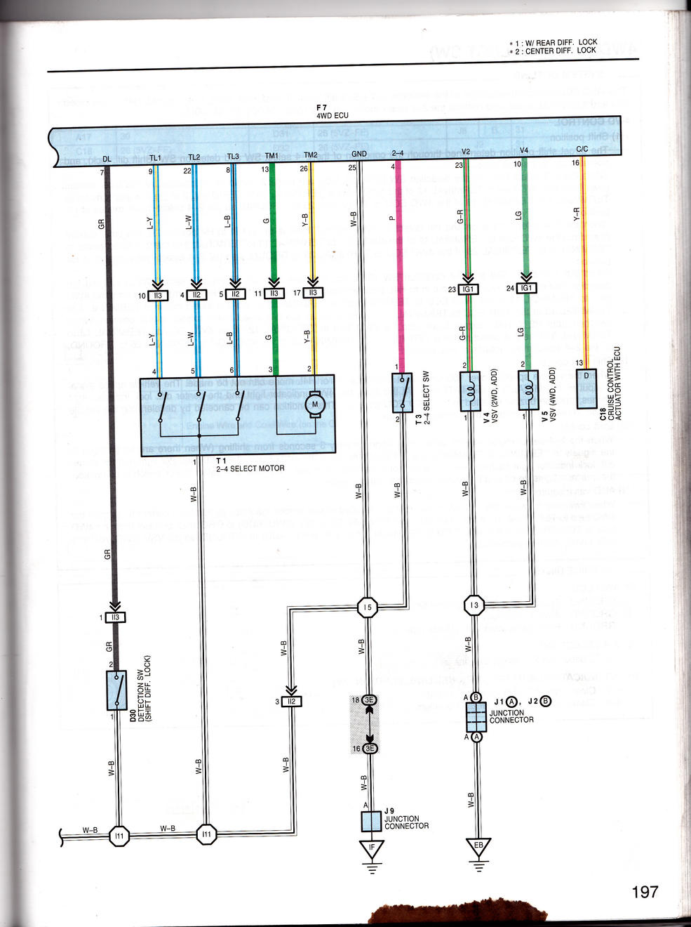

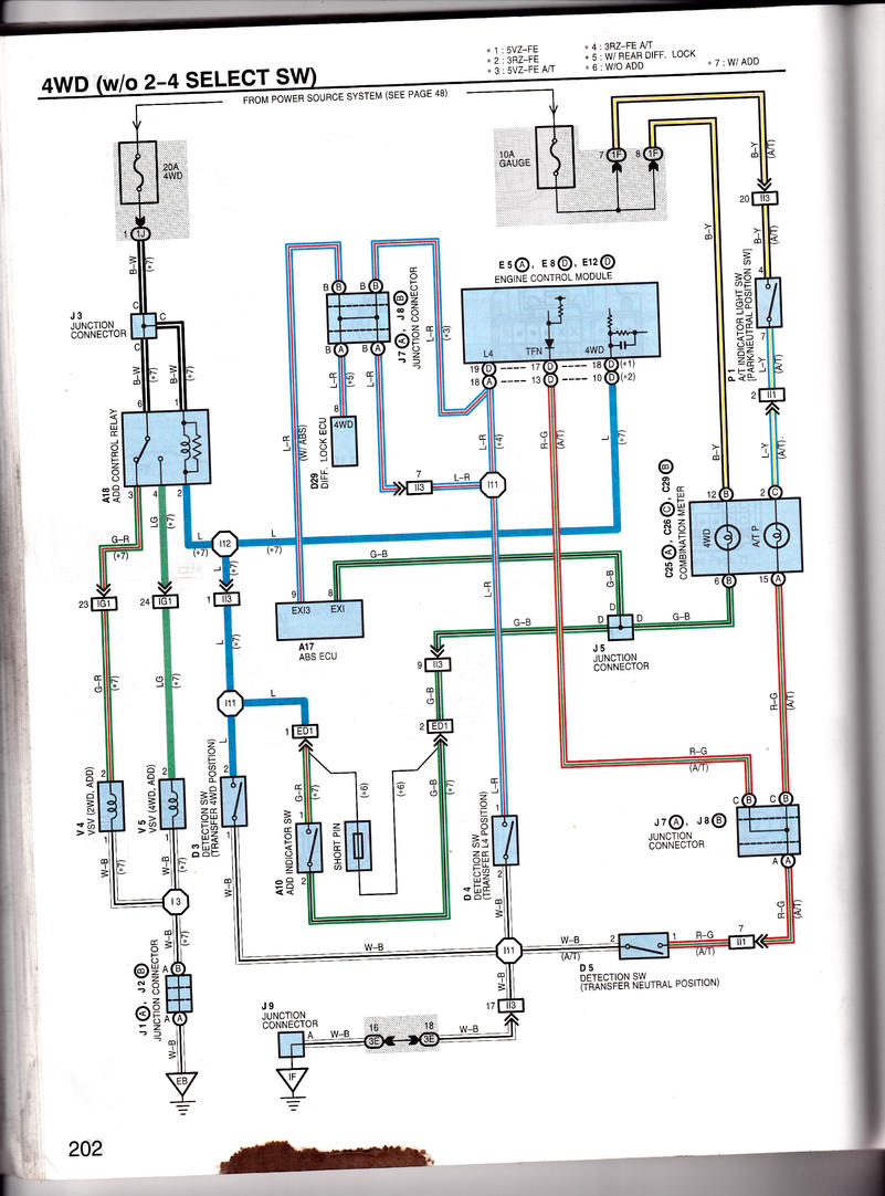

Here is the J-shift EWD from '99. I would think the '98 was identical. Did your '98 harness include the ADD control relay shown? I would think the easiest way is to use that relay and connect the J-shift TC to the ADD VSV's indpendent of what you do as far as the engine/trans wiring. To use the J-shift switches with the 4wd ECU from the auto harness probably won't work as, well, you don't have all the switches. But connecting up the VSV/ADD/TC part on its own should not be a problem.
Here is the EWD for the pushbutton TC/ADD circuit. See what I mean?
Ok. So I should have the relay. And basically what your saying is to run the two plugs off the j shift, straight through the relay?
And the biggest problem with that then is that I don't know how to wire up the clutch pedal without the automatic harness....
