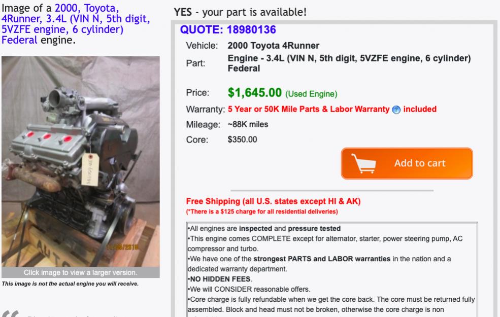

Just for fun I went on one of the big used engine sites and got a quote....
When I chose Federal Spec the engine was 200 dollars cheaper but has 10K more miles on it than when I selected CA spec.
Here is the link if you want to play around with it. Used Engines For Sale | Preowned engines | Southwest Engines
You have to enter an email address but the quote appears instantly in your browser as well. I got a quote for a transmission from these guys or a site just like it and a week later got an 'offer' to knock a couple hundred off the price. They also accept 'reasonable offers'. No idea if this is a legit path.....shipping the core back to them seems like a bit of a ha$$le.......
