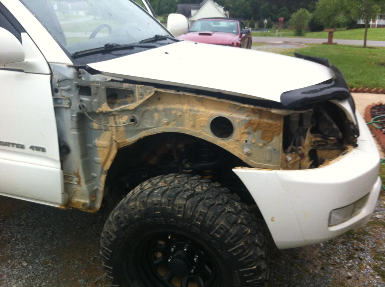

They are crawling/squeezing through holes in the body itself. If you took the fenders off the vehicle you'd see that the body is not solid sheetmetal, it's got lots of holes and gaps they can run through on their way under the plastic windshield cowl.

The holes don't only lead to the cowl, but between all the openings the mice can crawl their way under the cowl very easily. None of the holes though lead INTO the vehicle except for the opening for the HVAC system above the CAF. The Holes are mainly there to reduce weight, allow some components to pass through, and provide specifically designed crumple zones.
These are what I am talking about in terms of the vents:
They are located under the bumper skin and... I actually don't know exactly what they are for, but my best assumption is the are a "one-way" flap valve to help reduce pressure build up in the vehicle when driving.

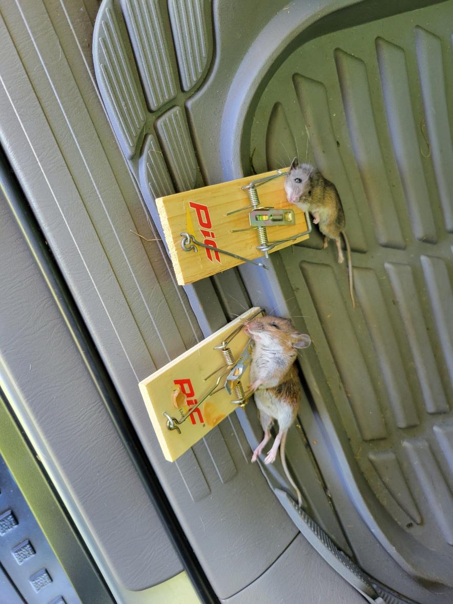

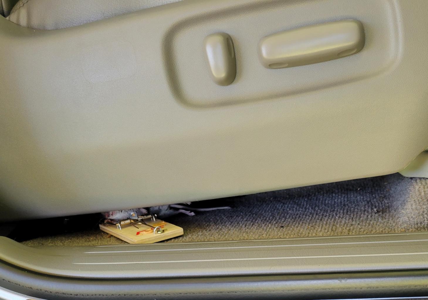

Being dealing with this myself and haven't been able to figure out how they are getting in. They can squeeze through openings we wouldn't think possible. I discovered my issue when I opened the glove box and all the napkins inside were chewed up and a large amount of padding or sound dampening material was also in there. I have not been able to discover where this material came from. I set 2 traps on each floor board mat with peanut butter as the bait. I modify the lever the trigger rod catches on so it takes the slightest movement to set them off. 12 hours later I have a dead mouse on the drivers mat and I didn't see the trap on the passenger mat where the second trap was set, up at the front. Only when I opened the passenger door did I see where the second trap was located. It was so far under the front seat that is was almost on the back floor mat. It was a big fat sucker too but how did it get so far under the seat? It's impossible that it was kicking or made any movement at all to get it so far back. The mouse was DOA as soon as the trap was sprung, how it ended up almost 2 ft away as well as it being under a seat is beyond me? Did four of his buddies try carrying him out like medics do on a stretcher, aka mouse trap? This has really messed with my head trying to figure it out. I have thick wire grid screen blocking all passages that I could find. I haven't found any pellets that would mean they have been living in my 4Runner for awhile. I have set traps under the car by the front tire and usually find one dead the next morning. I'm going to get some Lemon Pledge because it's only a matter of time before they start chewing on important and expensive things!!!!!
NCH
NCH
I have mice around my home and I have traps everywhere, you would be surprised how long a mouse can live after springing a trap, even if it looks like it killed them instantly, I have sat and watched as some have sprung the traps, I seen mice that got hit right behind the head resulting in a broken neck and some getting hit on the head resulting in a crushed skull and they still crawled several inches to sometimes a foot or more before stopping for good.
It's just adrenaline keeping them going, now if a broken neck or crushed skull causes spinal cord damage and them to be parallelized then they won't move, but otherwise they almost always move a little bit.
