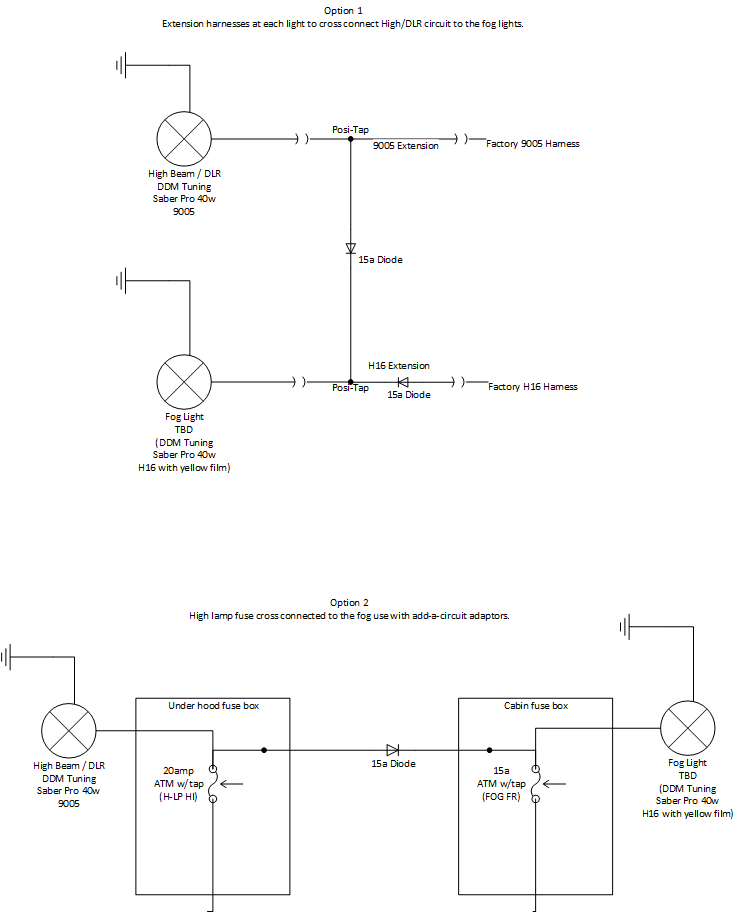

What I'm thinking is the following and doing in a way that removable. I really don't want to make permanent changes.
  • DRL - High beams and fog lights run at a lower power
  • Low beams - Fog lights function with OEM switch (on/off)
  • High beams - Fog lights come on regardless of OEM switch
My thoughts were that moving from standard halogen bulbs to LED would lower the voltage draw to a point where cross connecting lighting circuits wouldn't blow a fuse. This means I could effectively cross connect (with a diode) to loop my fog lights into the High/DRL.
The Saber Pro 40w bulbs draw 3.3a per bulb (per DDM). If I was to power the fogs off the high beam, the total draw would be about 6.6a. This is still less then OEM fuse and slightly higher then the halogen 9005 (5.4-ish amps).
Option 1
Install and extension harness on the High/DRL and Fog lights. Then connect the hot side of the High/DLR to the hot side of the Fog lights. To stop the fog lights from running the high beams, there will be a diode in the cross connect. All the wiring will be contained in the front near the lights.

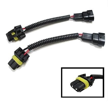

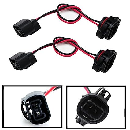

H16 Extension
https://www.amazon.com/iJDMTOY-Extension-Harness-Headlights-Retrofit/dp/B00H5A4I6K/
9005 Extension
https://www.amazon.com/iJDMTOY-Extension-Harness-Adapters-Sockets/dp/B008E00TKY/

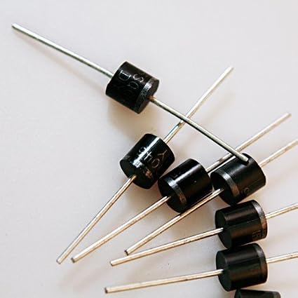

15a Diode
https://www.amazon.com/Akak-Quality-Schottky-Blocking-15SQ045/dp/B01CXOQMJ8/
Option 2
Connect the 'H-LP HI' fuse to the 'FOG FR' fuse using add-a-circuit fuse adaptors. I haven't checked the fuse location yet, but I'm assuming 'H-LP HI' is the right one. One concern here is I would need to bring a new wire through the firewall. I'm not sure how much of a pain that will be. There would also be a diode to prevent the fogs from lighting the high beams.

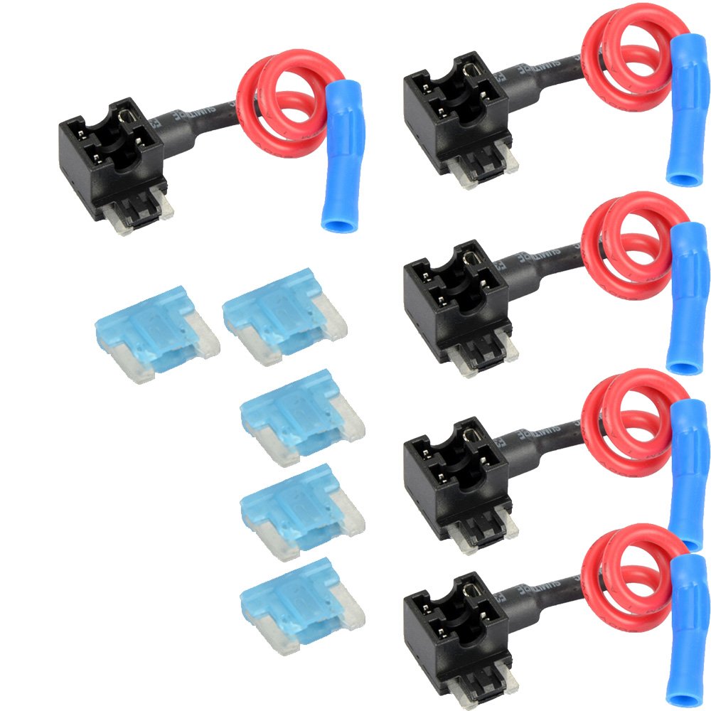

Add-a-circuit fuse connector
https://www.amazon.com/Support-circuit-Adapter-Blade-Holder/dp/B00SUX9V4K/
15a Diode
