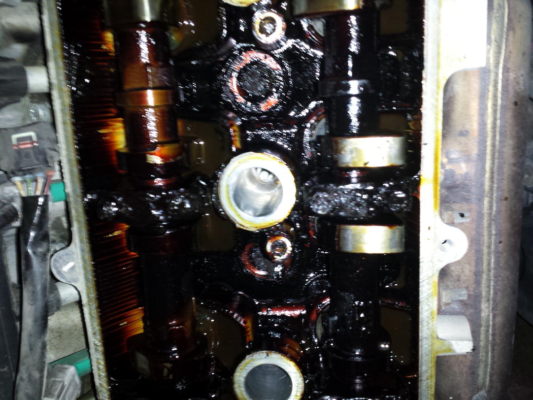

hello guys. I used mystery oil and it did take care of the oil lamp for a while. It then started to whine bad and oil light came back. changed oil and put lucas stabilizer and synthetic oil. i know this doesn't sound right but i was trying anything. nothing still. pulled out the valve cover gasket to see what the heck is going on and geez, so much build up. so before i have to change the motor as a last resource. and because the motor isn't ticking or knocking yet. what is the best way to flush all this crap?

wow definetly in b ad shape....really interested in how u finally resolve this, i bet u bought the car used?..any history?..1 owner car?
I hate to say it, but if you read my post; I called it. Exactly this. Sludge.
First, stop using all those dang add on chemicals and gimmicks. They don't work and at worst can royally screw something up. When you mean flush, you really mean what do you throw in while driving to fix it? You don't. Any chemical harsh enough to tackle this will destroy your current oil as well. Not only that, it can send chunks of crud racing around killing stuff. The only way to deal with this is a complete breakdown.
How do you fix this without destroying the engine? Complete breakdown. This engine is the product of previous owners doing 0 maintenance. I have not heard of any serious issues with the 4 gens and sludge, which tells me that when taken care of.. it doesn't sludge up.
You tend to get sludge when a PO runs like 20k on crappy conventional oil and the oil completely breaks down.
My thoughts are, break her down.
