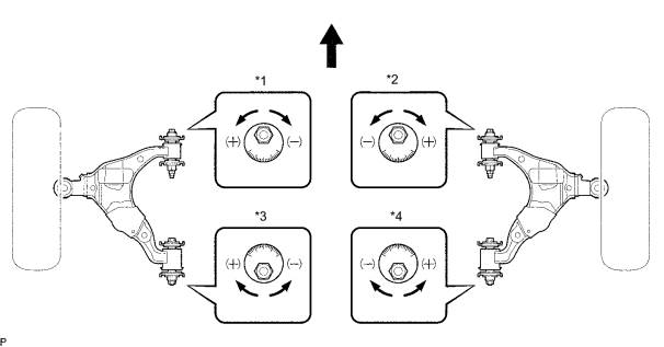

Each lower control arm has 2 eccentric adjusters, 1 at the front, 1 at the back. Adjust the ones at the back of each LCA so that the bolt is furthest outboard of the vehicle. This pushes the lower ball joint forward, increasing caster.

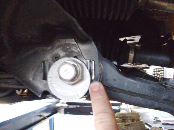

Couldn't find a good picture, this is one of the front bolt, but they look similar. This one is at about 1 o'clock, you want it to be at 3 o'clock.

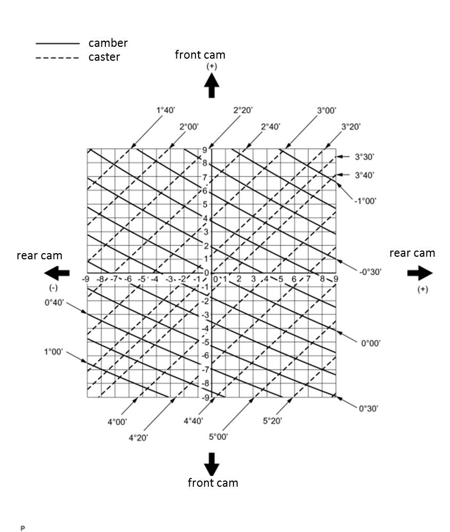

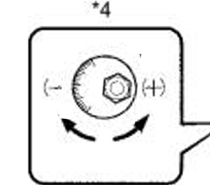

Here is a guide on the cams.... If the side they say that has the least caster does not have the rear A-arm cam pushing the arm outboard....(example shown for drivers side rear) they did not do it right. As Jeremmy556 stated. The bolt should be outboard. The high point of the cam should be inboard.

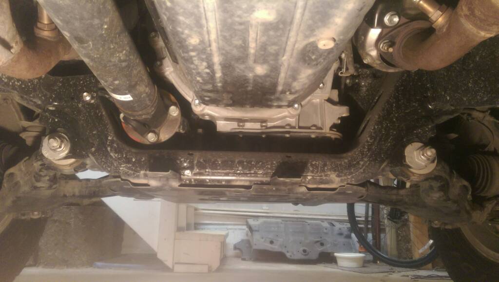

Crawled under the truck this morning to take a look at the cam bolts.
So it looks to me as if the passenger side cam is 180° out of phase (pointed to 3 o'clock rather than the 9 it should be), providing the minimum amount of caster?
Another stupid question. I have yet to install the diff drop spacers. I know this won't affect the alignment per say, but by not installing could it binding the system since the effective width is shortened? If I install the drop kit would it provide some additional free play?
Actually, your passenger side cam is on the correct side, the driver's side is on the wrong side.
Don't install the diff drop. It only lowers the diff about 1/4" where it counts, messes up your skid plates and you lose clearance, for no benefit.
Yea, looks like the passenger side is at least started in the right direction. Driver side has way more adjustment in it.
Depending on where that passenger front cam is, that side may be maxed out. Without seeing it, I'm guessing the tech could get a little more camber and caster out of the passenger front cam. Then that side will be maxed out. Next, adjust the driver side so the angles match the passenger side. The cams won't be in the same positions from side to side. That is similar to how my 5th gen ended up. Camburg may build in 2° extra caster but they only do it to the driver side UCA.
