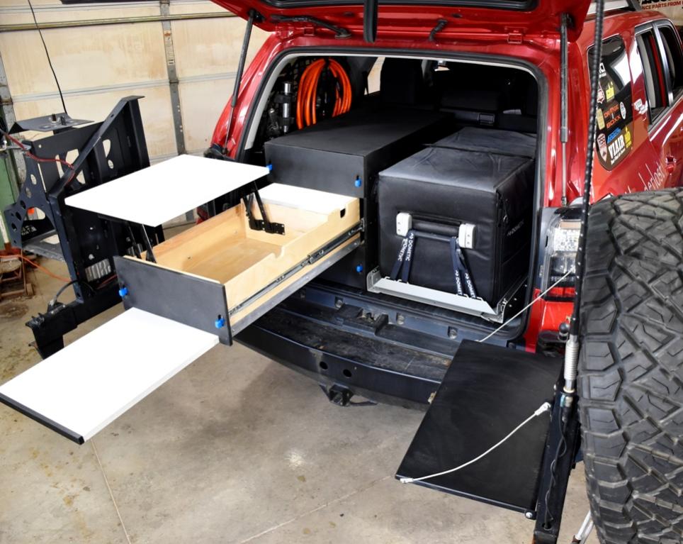

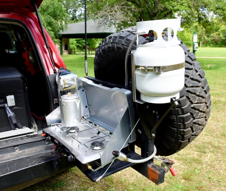

My custom setup. Goal: Max compact storage and systems minus the weight.
ARB 5" drawer with slide
Custom table top on ARB drawer
Custom storage on the left with L-track tie down rails
Custom LFP battery (solar charge)
Water pump with quick disconnect
Fridge wiring, etc
OrangeBoxx molle panels
and Raingler nets

It's still very much a work in progress. We're adding a mount for a 5# propane tank this afternoon.

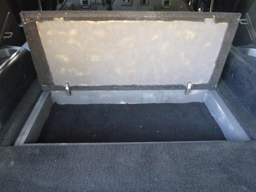

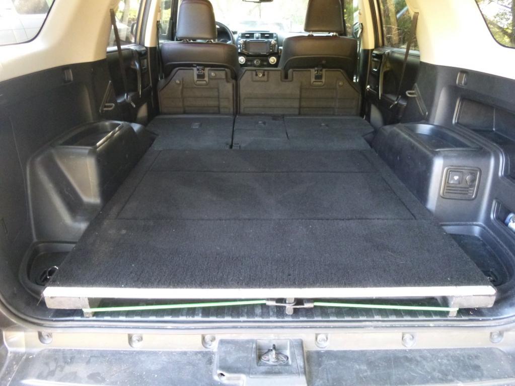

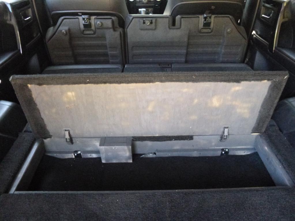

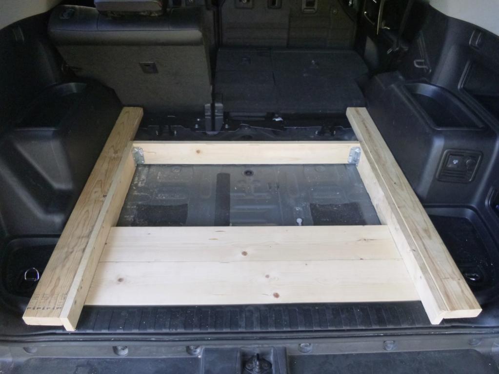

It's nothing fancy but came out as I expected. Raised platform is even with the back seats folded down. I wanted access to my tool kit, jumper cables, and tow strap so I made the rear load tray. Drawers would have been nice but there was no room with keeping the deck low. I didn't even have room for a door and just used bungee cords. Rear tray is 36x13x2.75, middle compartment is 36x14.5x4, and front compartment is 36x10x4. I'm still trying to decide what to do with the rear corner pockets.
