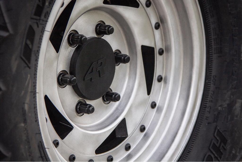

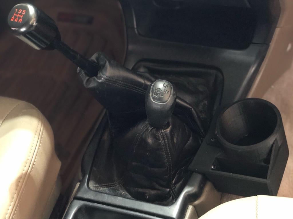

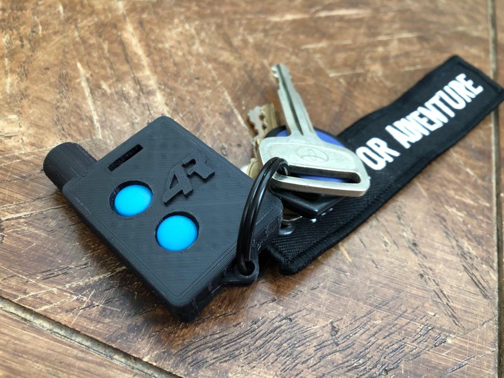

I designed and printed my centercaps, cupholder, swingout catch(no pic) and a replacement remote for the aftermarket alarm that the PO put on it.

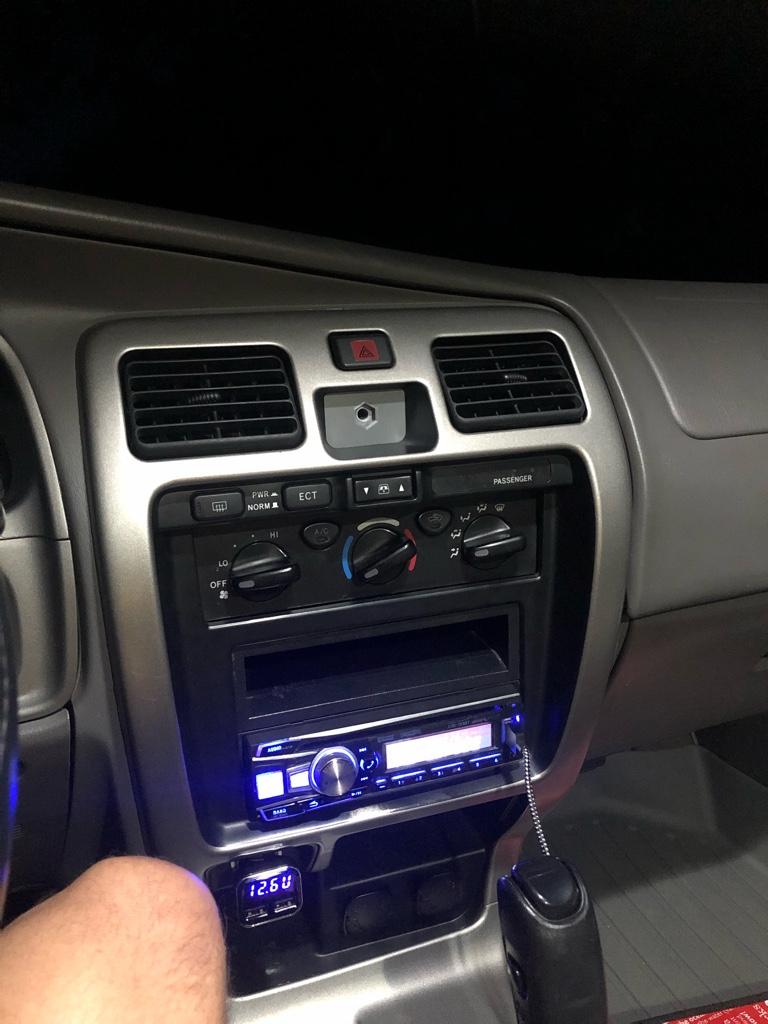

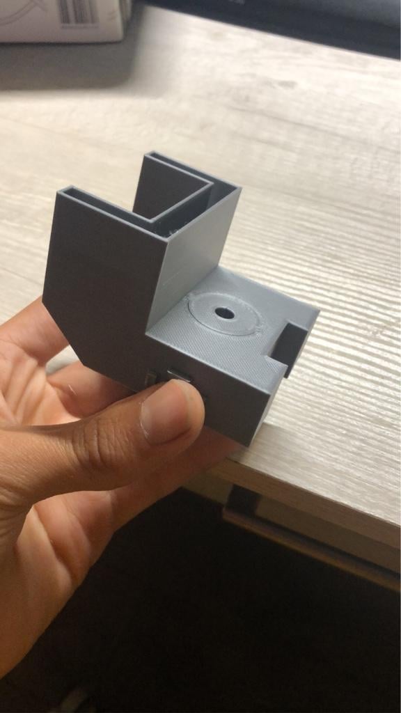

I am currently designing a mount receiver bracket (dubbed the clock block) that deletes the original clock location and adds a rigid mounting location. It snaps on using the same dimensions as the clock. Will be testing it as soon as my ram mount adapter arrives.
The grey piece is PLA, however I have printed a PETG model since which will be what I use in the car.

Now that is something I would be interested in! I want to add a phone mount, but hate all the options out there. I was thinking about ditching the clock and fabbing something there. I can't wait to see it done!
Gotta love those cup holders. They come in clutch.
For sure, theres a guy on here that sells them and i about bought one but my wife got me a 3d printer for my bday so i had to take a stab at my own. His are definitely more legit

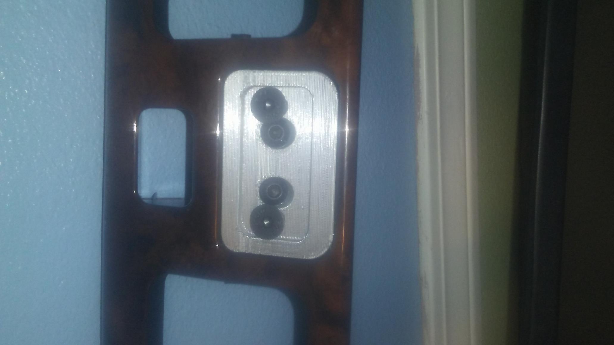

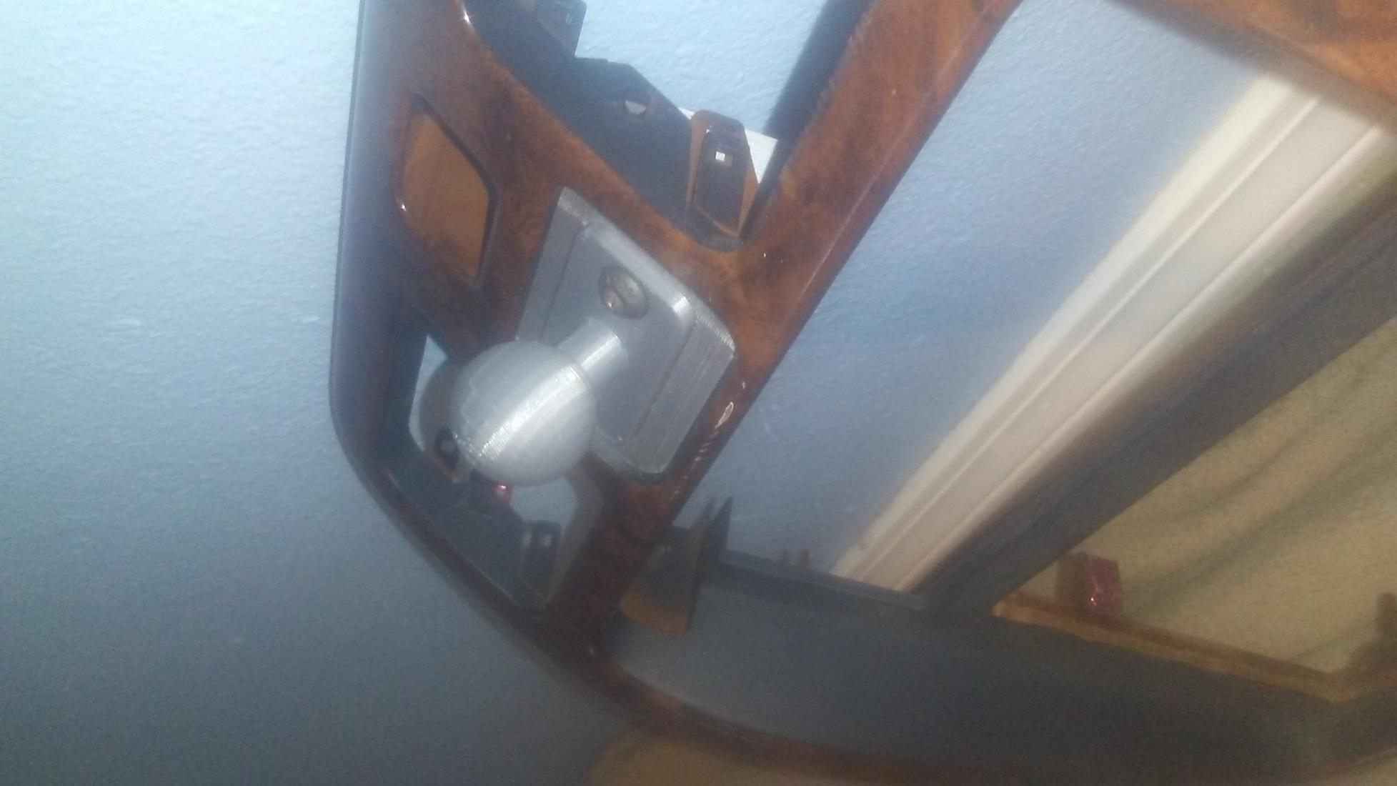

"I am currently designing a mount receiver bracket (dubbed the clock block) that deletes the original clock location and adds a rigid mounting location. It snaps on using the same dimensions as the clock. Will be testing it as soon as my ram mount adapter arrives"

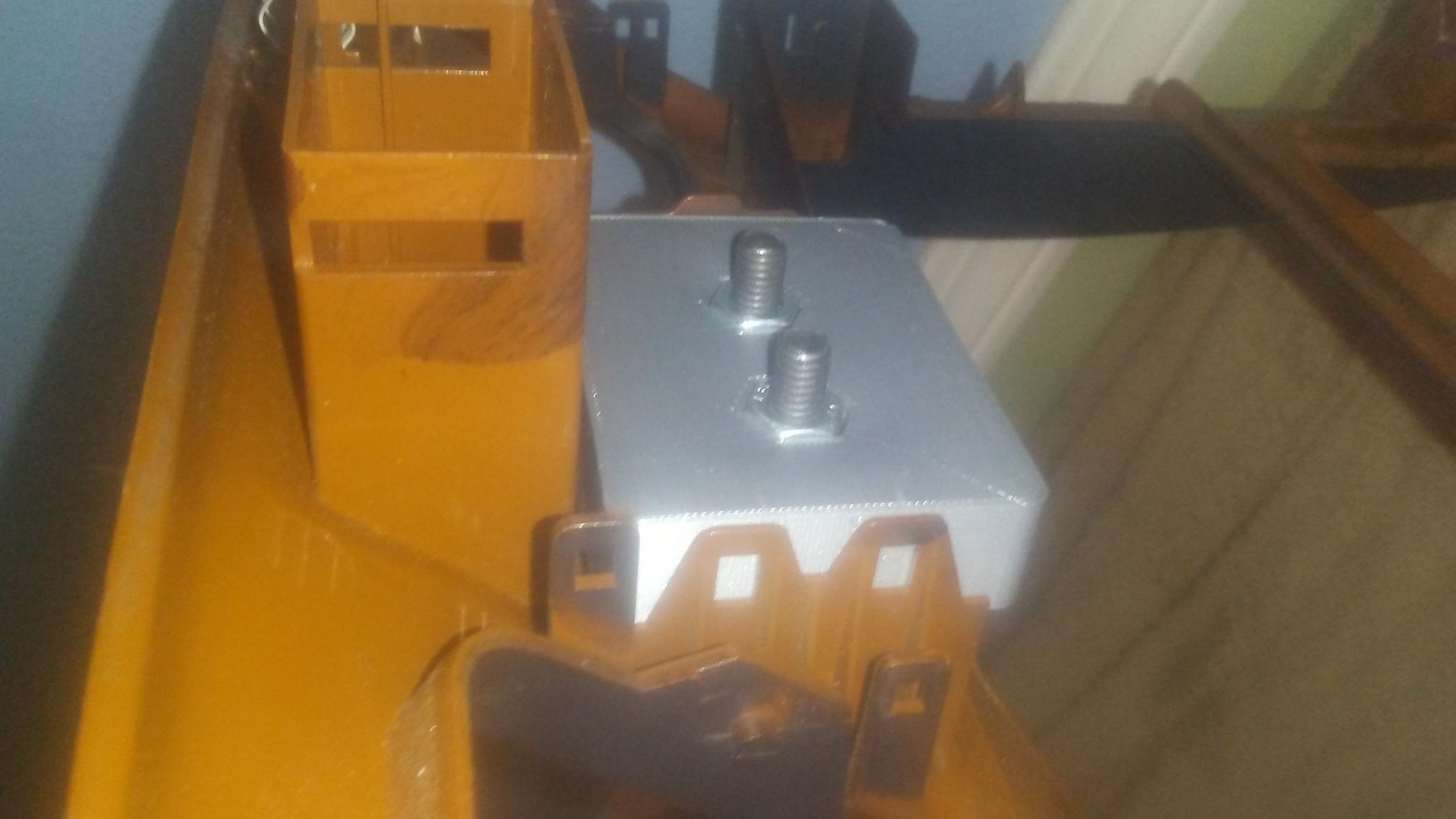

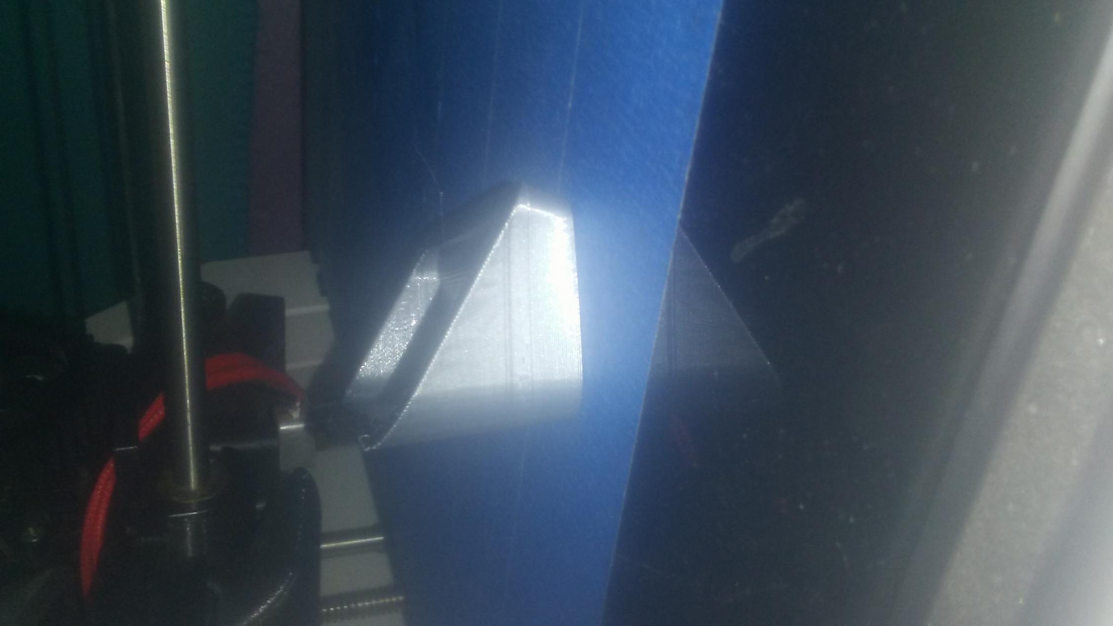

Looks like Sean put his feelers out there...lol. Here is my Ram Mount clock adapter. Gloves itself in the pocket and is clam-shell bolted to the bezel for ultimate in sheer and strength (the bezel will break before this thing comes loose). I decided to clam shell bolt it because the mount tabs for the clock are really only designed to hold the clock itself, nothing more. Didn't want to take the chance of if snapping the tiny tabs due to the leveraged weight it will be seeing. I also wanted to pull it out of the pocket a bit so there isn't interference with the adapter arm and the bezel, for greater mounting angles. The 3D printed mount is just for scope, avail for both bezel types. Working on a cupholder variety as well. Also waiting on my Ram Mount....get on it Sean..lol

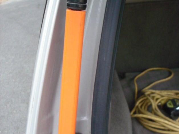

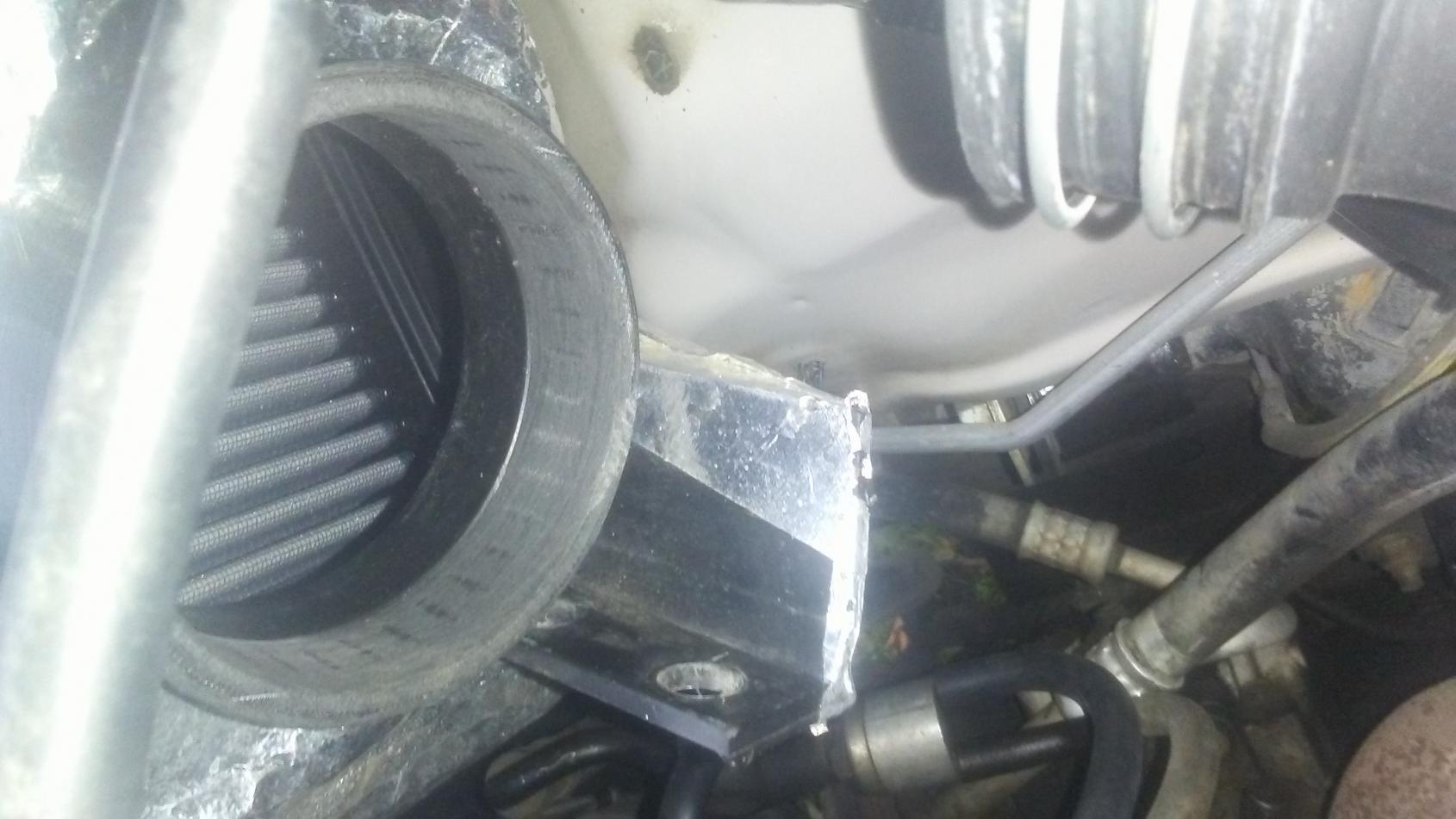

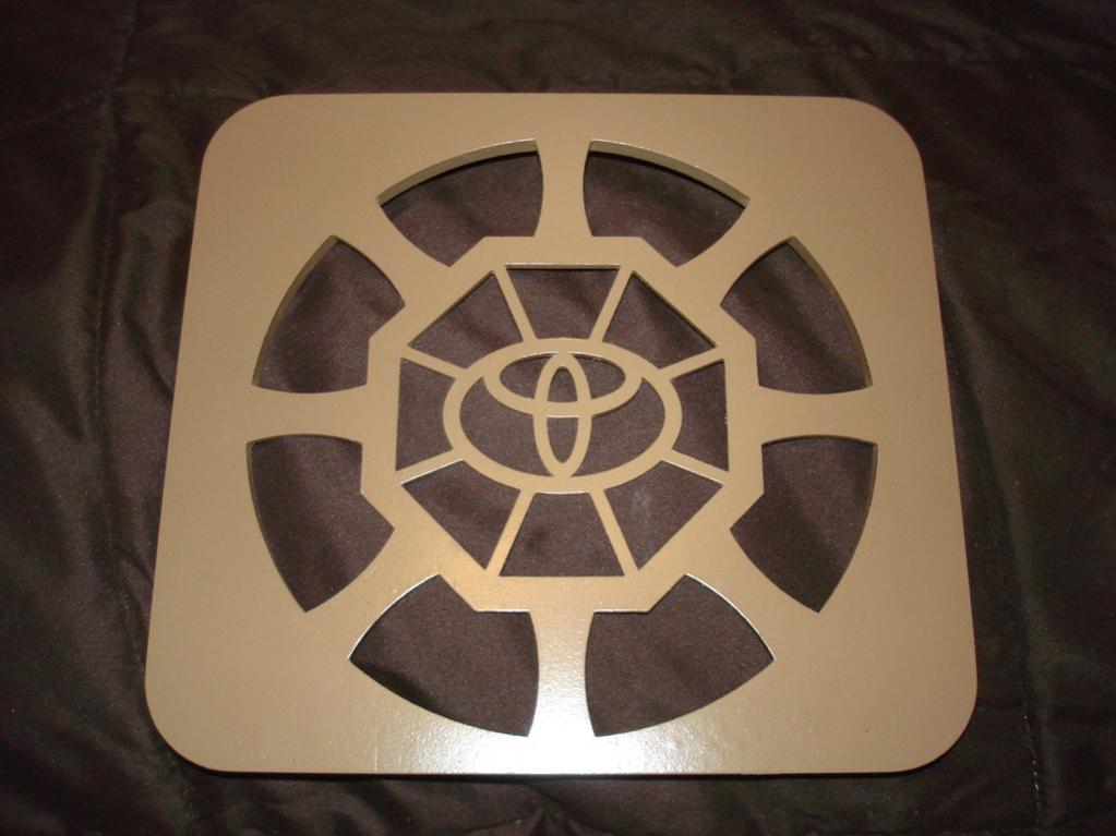

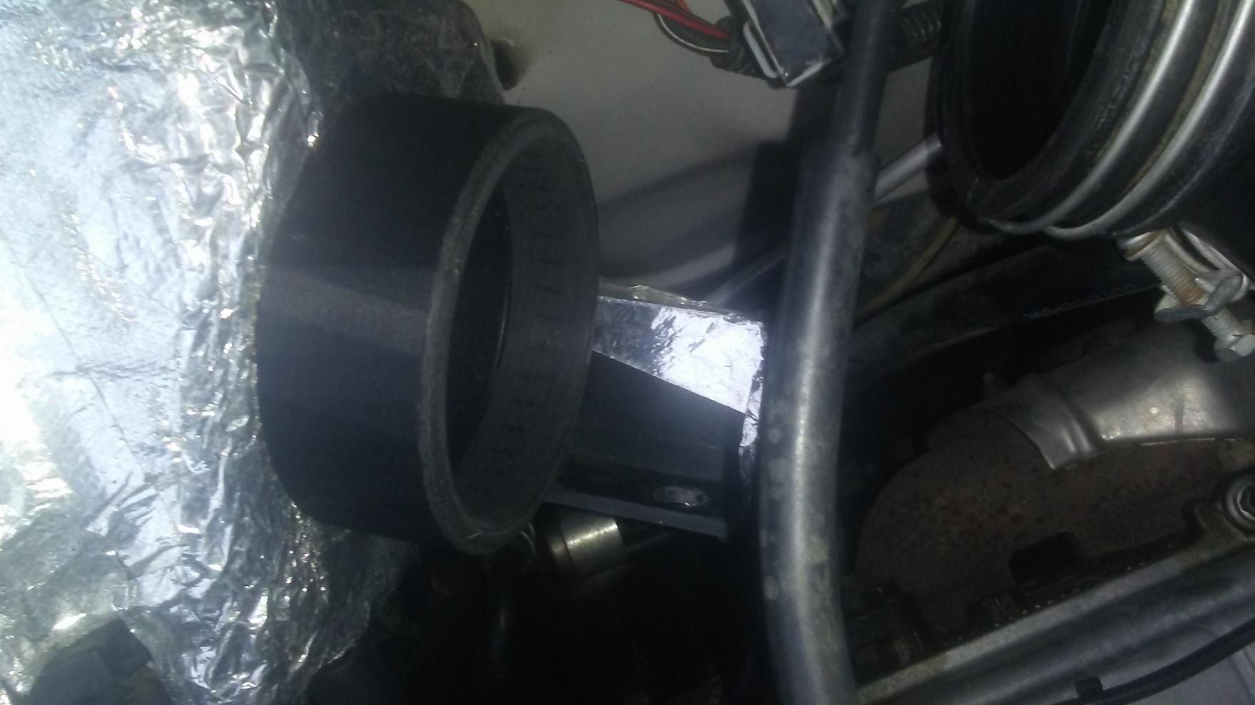

And some more for giggles...
97 Airbox to 01 MAF Adapter
97 Rear cargo subwoofer cover
Strut brace for saggy struts

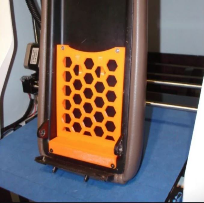

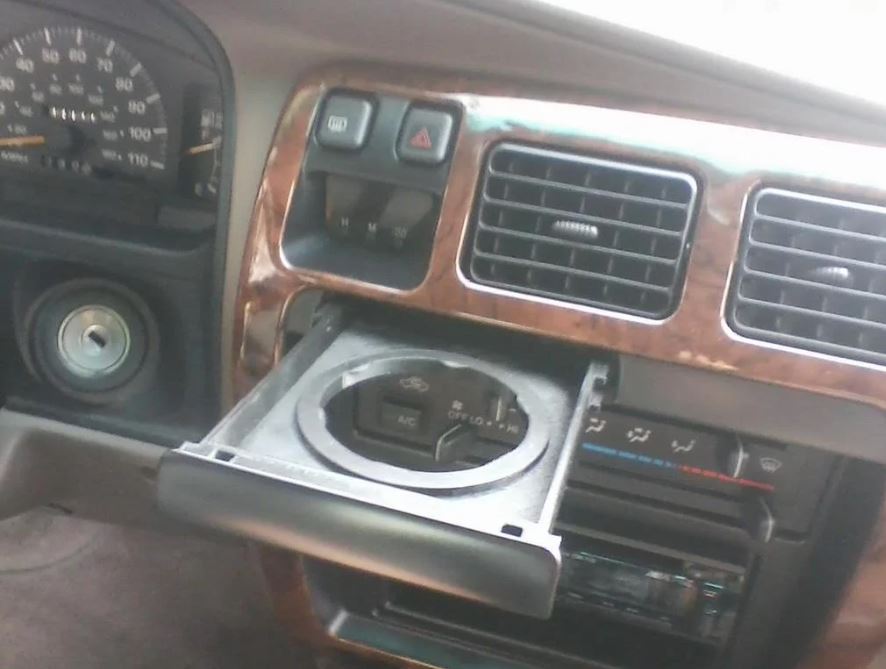

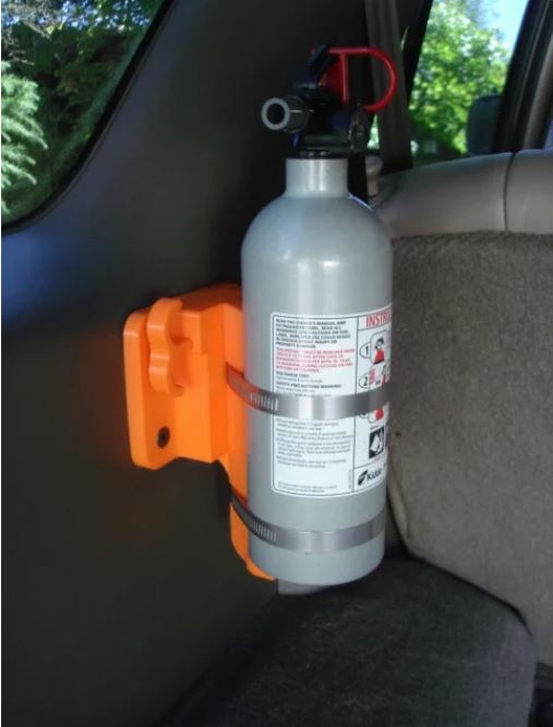

And some more...
97 Console documentation holder
Fire Extinguisher mount
Replacement Multi Cup Holder

seeing your bass cover....looks near factory color....so one item that would be of interest to some....including me...is a door for a storage compartement on the driver's side....in the back....opposite the one that is on the pass side.
People talk about finding a way to make that space usable and the issue is the door.. texture grain and color. something that would work like the stock one..

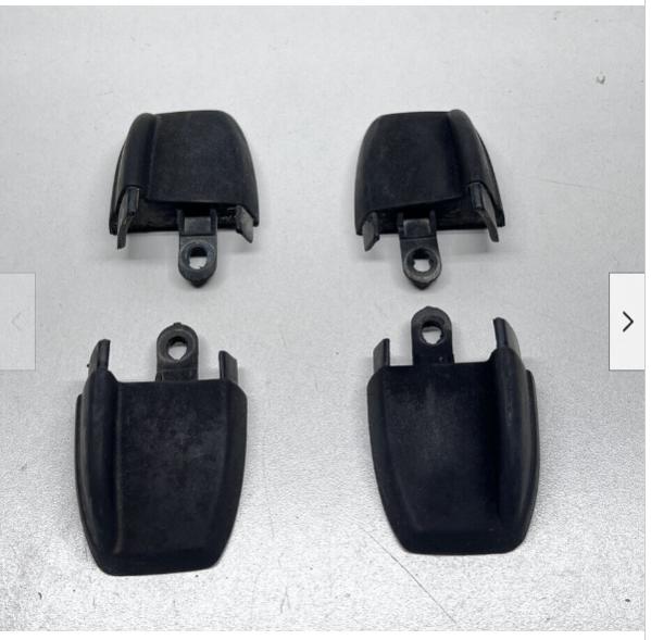

oem roof rack track end caps 3rd Gen
Anybody have the files for these?
