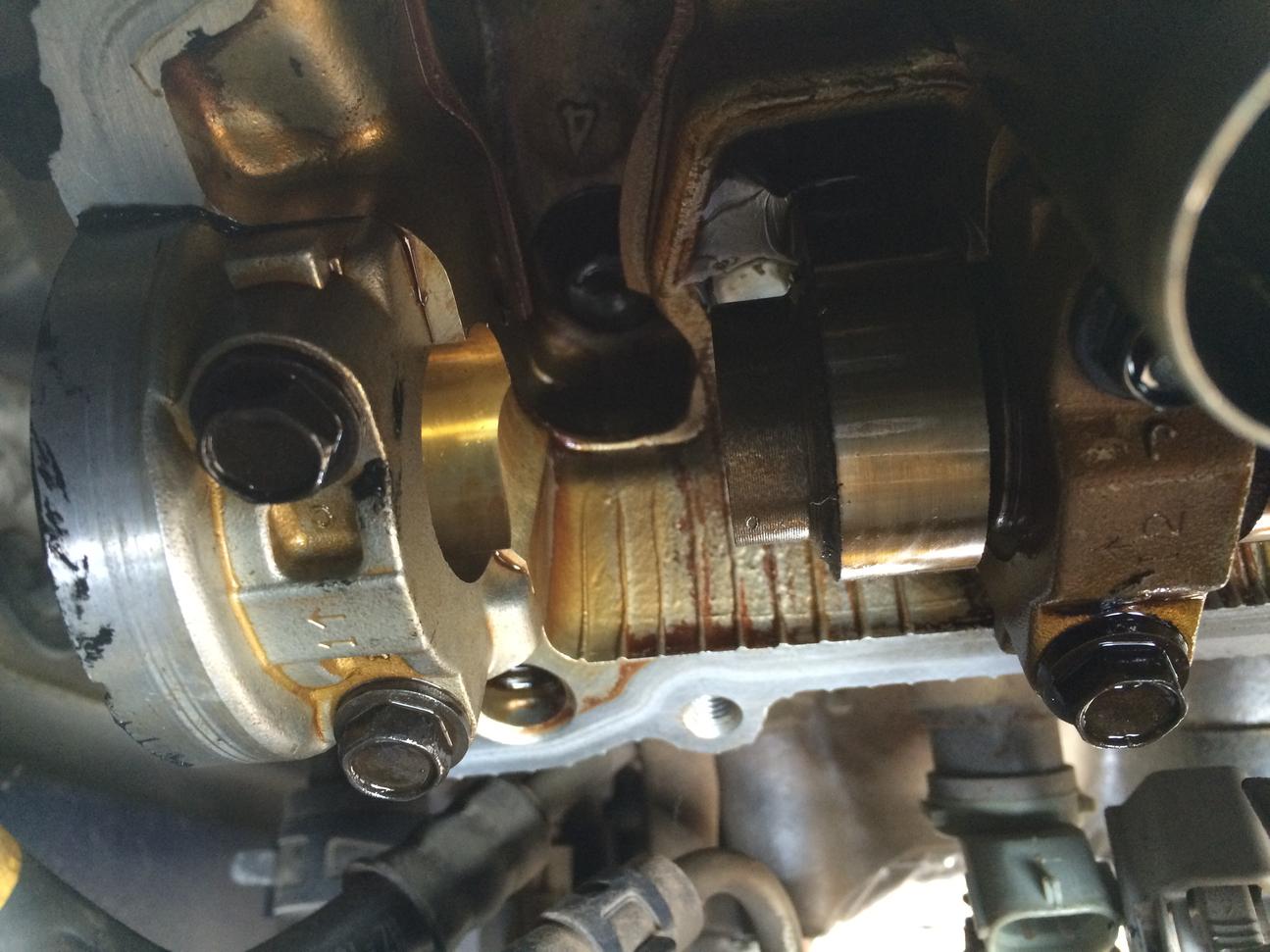

Might have just answered my question. Does this look like the culprit? This is the best photo I could get of the cam shaft seal. ImageUploadedByTapatalk1439056544.264744.jpg

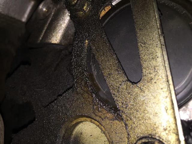

Hi Tony, I replaced my valve cover gaskets two months ago. You should not smell any oil burning after replacing them. The camshaft housing plugs you took pics are of to be cleaned up and FIPG applied to both sides of the bracket that holds them down. Should look like this. I took this while doing my 5vz fe

Yep, just did it all over again to replace the camshaft plugs. I got a new set from the dealer at 1, started at 2, and just cleaned up at 8. All told, 6 hours is way better than the 2 days it took me last time! Here's to hoping that did the trick. Cleaning off the FIPG I just applied a few weeks ago was the most time consuming part. Oye. Thanks!
Took a 300 mile trip yesterday and I'm happy to report that the burning oil smell went away after about a half hour. I had to pop the hood when I got home to see if I could smell any burning oil and it just wasn't there anymore. Feels good.
Let that be a lesson to the other poor souls who pull their engines apart on their only car, ready to do this job only to realize the "kit" they bought off eBay is missing the camshaft housing plugs. Put the engine back together and go get them before you do this job. Most of my time was spent scrubbing FIPG off mating surfaces. You have to remove the FIPG every time you pull these things apart, so you're just doing work you'll have to do over again.
Sure, you might be able to get away with just cleaning the existing plugs and applying FIPG around it. However, my old plugs had a mm or so less rubber around the seal, and the new ones fit a lot more snugly. That told me a lot about why you need to just replace these.
