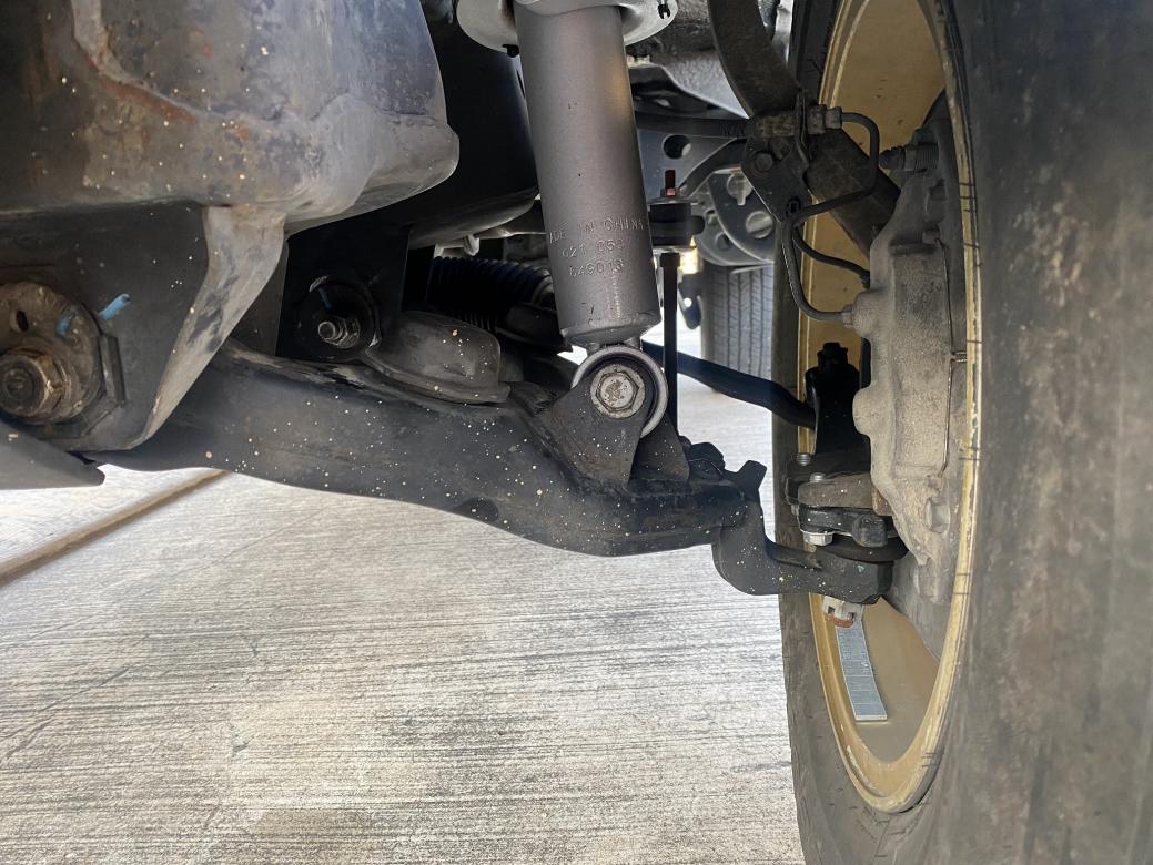

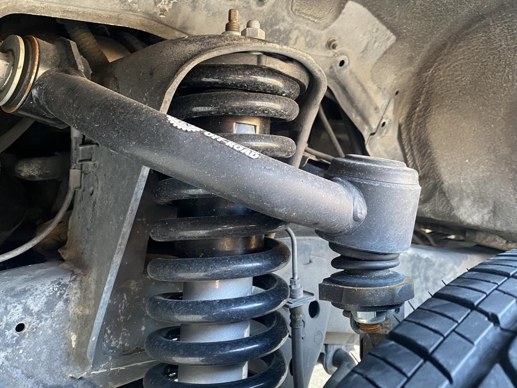

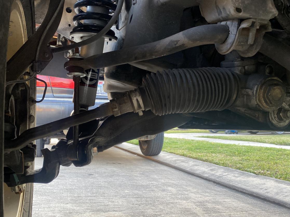

I did a Rough Country 3" lift on my 2WD.
I know my front is too high and I don't know the reason. Causing strange deflection on my LCA and LBJ.
Measured 25.5" both sides in the front.
RC is sending me a new front setup since they agree that this lifted it too high.
My thought is that even though they advertise it for both 2WD and 4WD, the spring rate was designed for the extra weight of the front diff and TC on a 4WD.
So the front doesnt have enough weight for it to sit how it needs to. Just my hypothesis.
Curious to know what other's have measured on the coilover (not spacer) lift on their RC kit!
Spacers or full replacement front shocks? Post a picture of the shocks in place. 25.5" front height is fully extended with the stock arms/ball joints - you have 0 droop travel right now.
2wd vs. 4wd will change the front height by maybe 3/4" - not 2-3"

Hopefully pictures post correctly. I hvae full replacement shocks, no spacers. I don't know what the issue could be. New LCA bushings (Whiteline) and Freedom offroad UCA's as well to try and prevent alignment issues. But it's deflecting my LCA so far down like i took a mid air jump and never came down.
Other photos are too large to post

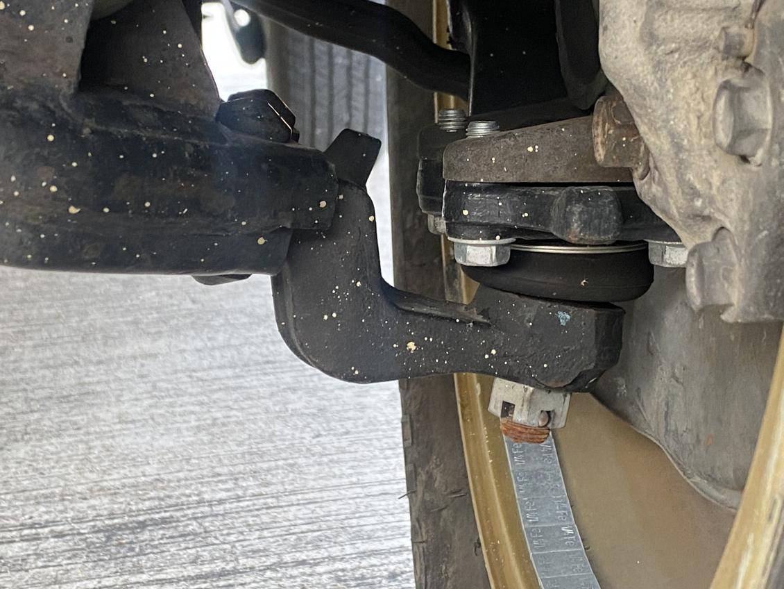

Meant to add this one as well
