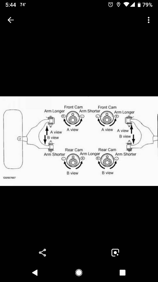

I'm pretty sure you're thinking of camber with regard to the LCA cam bolts. These move the LCA either inward or outward relative to the frame. In order to affect caster, you need to move the UCA forward/backward.
You need to pull up the FSM to get a visual of how it works, but in combination of the two lower cams and the triangulation of the LCA you can also do caster (as well as Camber).
Sent from my Pixel 2 using Tapatalk
Thanks, I stand corrected. I looked it up in the shop manual and can see how it works for caster. PITA compared to slotted UCAs, but likely more durable. You have to triangulate on both the front and rear LCA bolts with the lower ball joint as the 3rd corner of the triangle to shift it forward or rearward, and then correct the toe after you get caster & camber set correctly.
