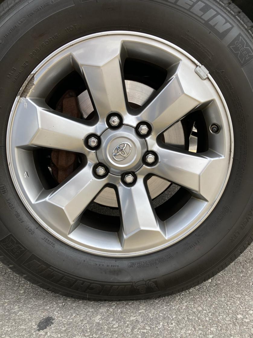

The finish on my ‘07 Limited wheels is starting to show it’s age. Mostly bubbling around the valve stems and flaking where the wheel weighte were/are. I checked on getting them powder coated glossy black (the least expensive way to go) and for the wheels, center caps, dismount and remount with road force balance is $520 or $660 for other colors. I have watched numerous YouTube videos on painting wheels. I am confident I can do it....but...I get frustrated when (1) things don’t go as planned, like getting fish eyes you cant get rid of, etc. or (2) you get the wheels to look perfect only to have durability issues after all your hard work. For those of you that have had your wheels refinished, what is your experience? To those who have painted them, the same...any regrets or tips?

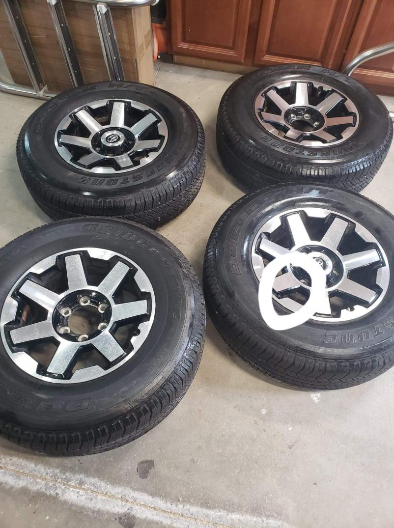

I found a set of “take-offs” wheels, center caps, TPMS and tires off a TRD Off Road for $300 more than the cost of going the powder coat route. Only 900 miles on them. One small scratch (circled in the pic) Sounds like a no brainer, huh?. The only caveat is they are “pick up only” and the guy lives 6 hours away. Will 4 tires/wheels fit in the back of the 4Runner? Day trip anyone?

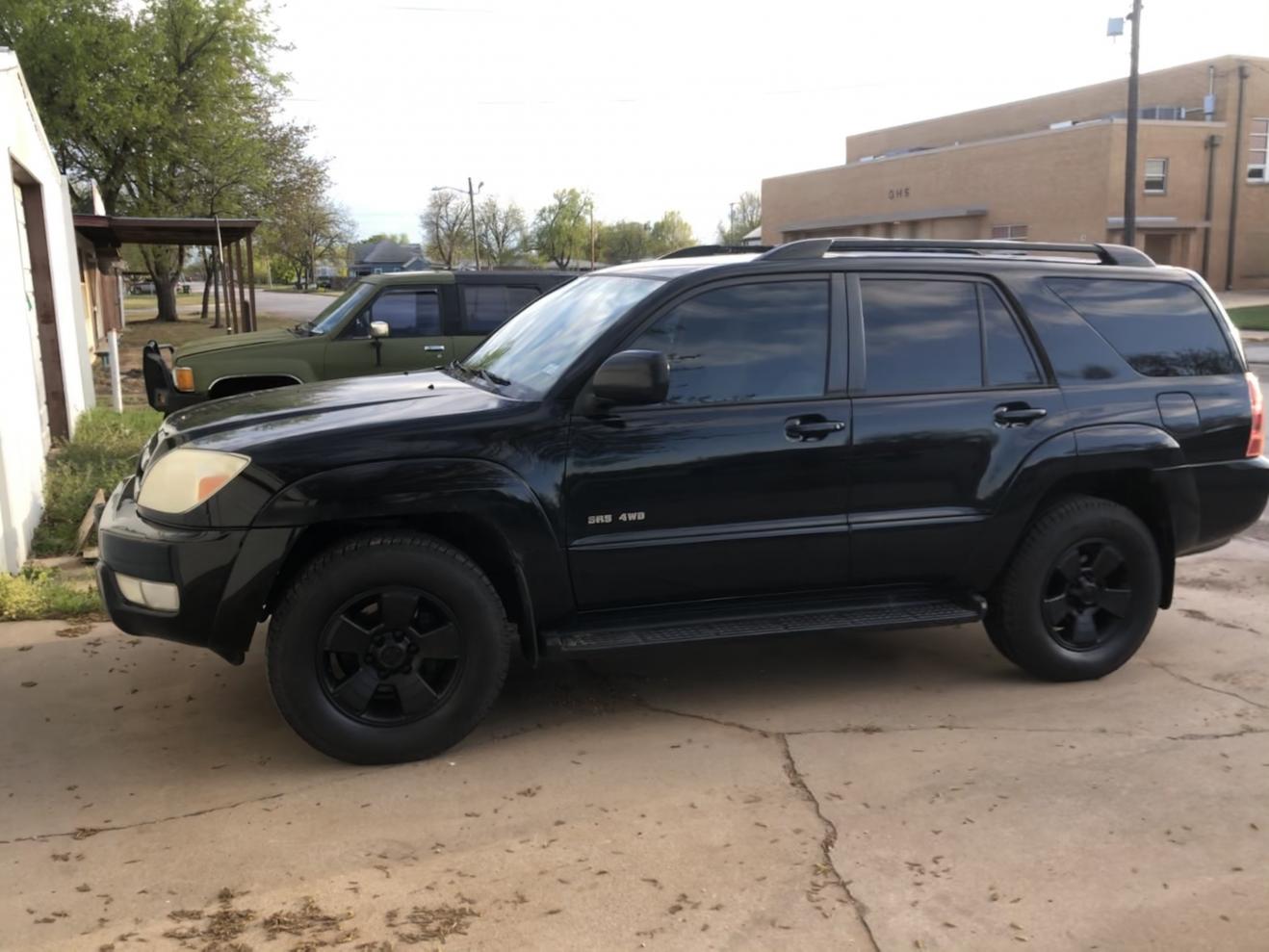

I did my stock wheels with about 2 cans of Plasti dip
I had 5 wheels with 285/70s mounted on them in the back of the 4runner. Gotta drop the rear seats but they will fit.
