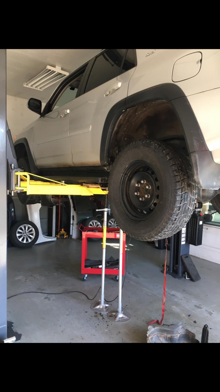

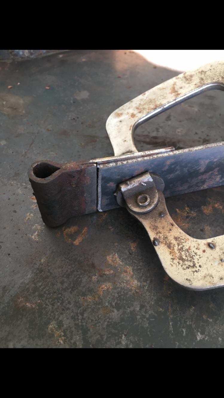

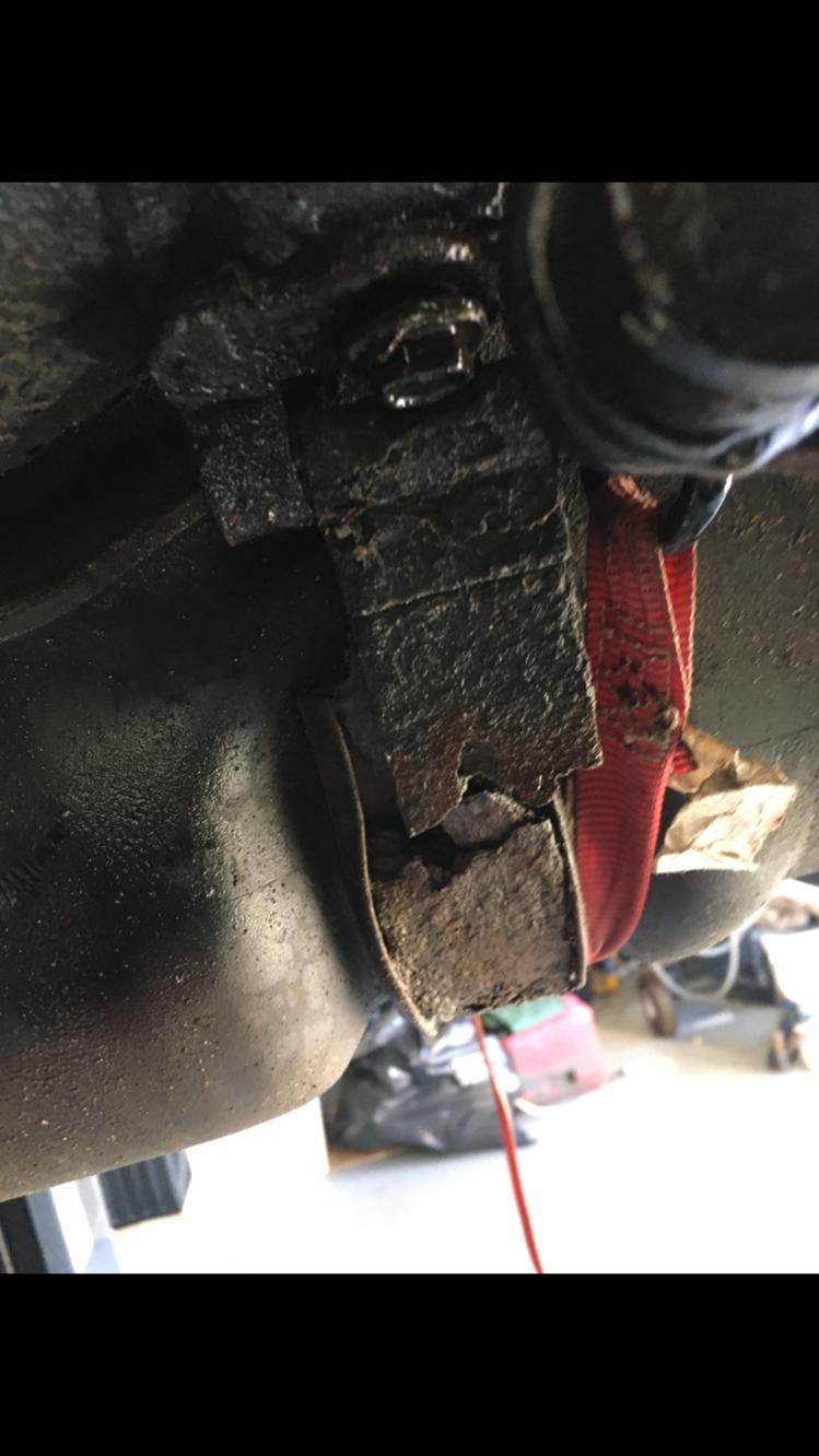

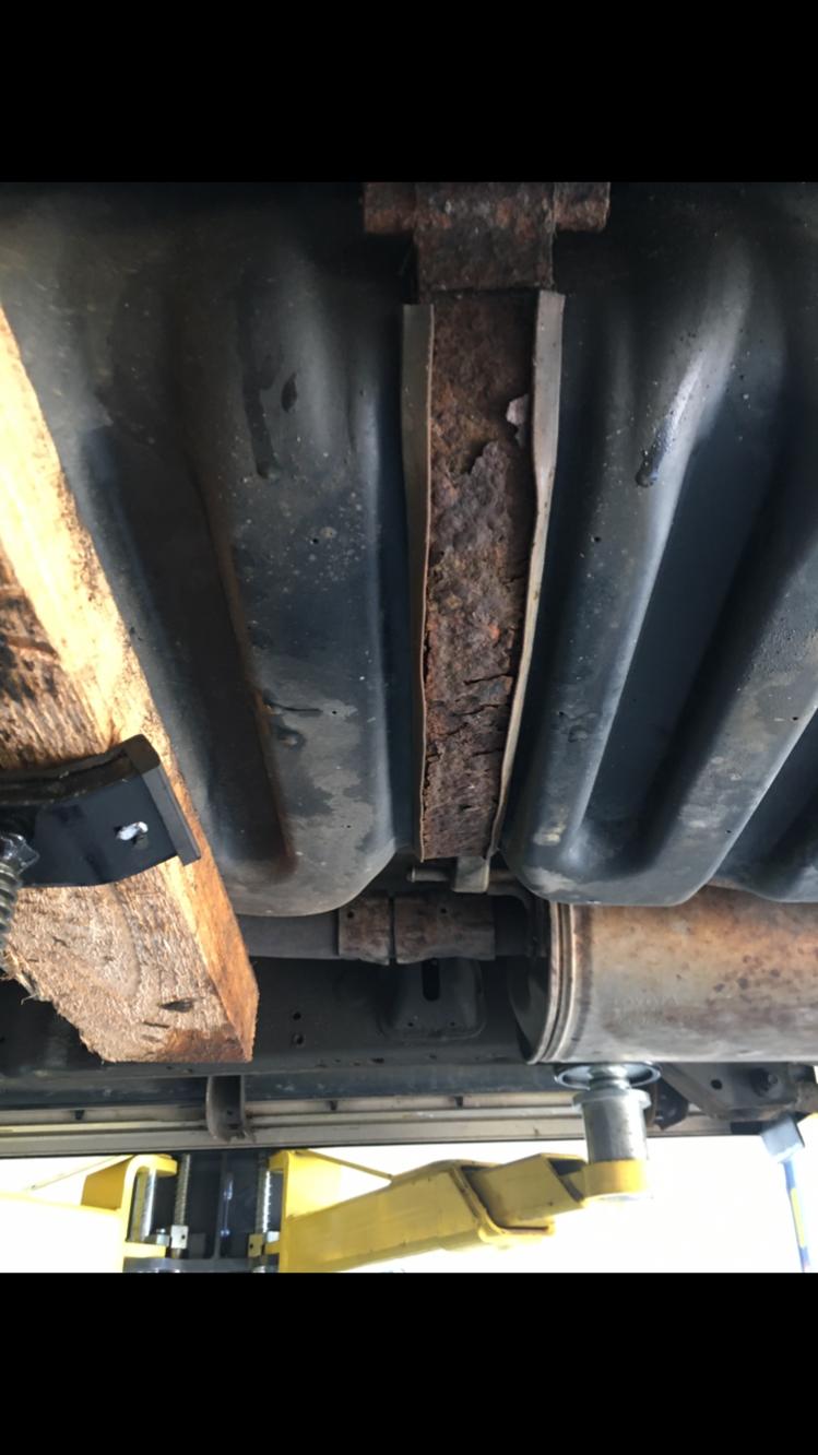

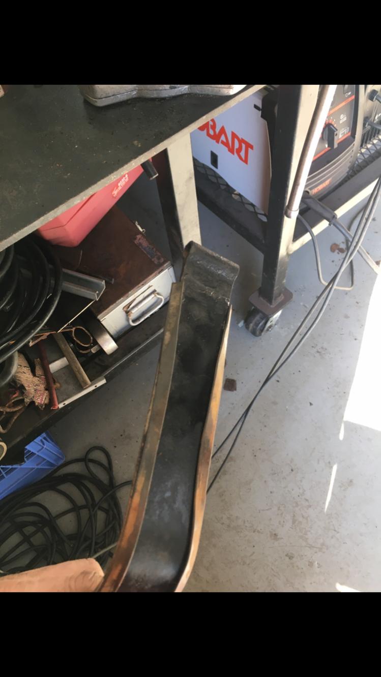

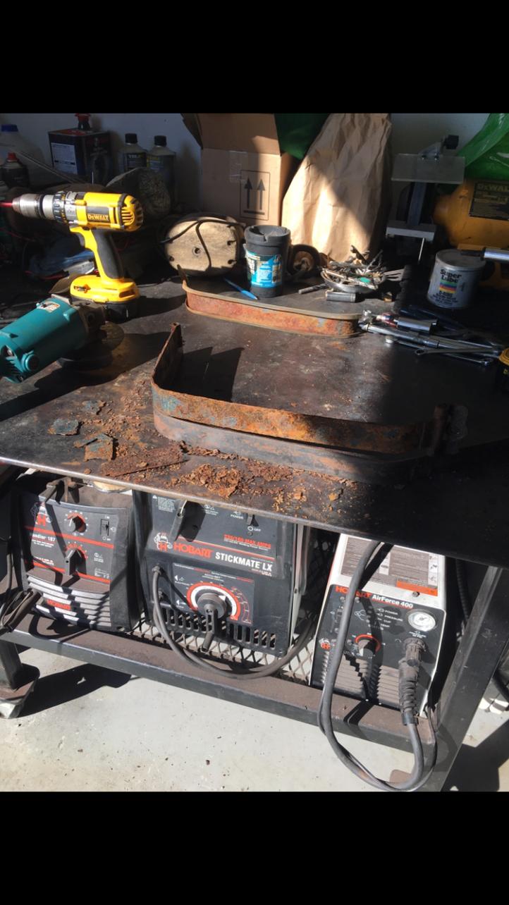

I just did this job too but , just used flat bar and bent it to same shape and welded the ends on , toyota wanted like $200 (cdn) per strap yes EACH and they were week away in US , was not paying that anyways they crazy
Few pics

Cost me like $5 in flat bar and an extra hour than if i had new straps sitting there ,
