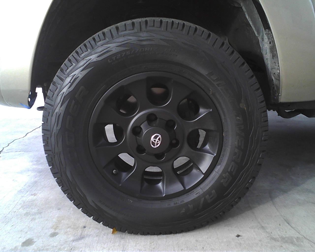

Pc-d TE wheels

My guy did not pc mine & just painted mine , pulled the toy badge out left it chrome , only chrome on my 4r !
