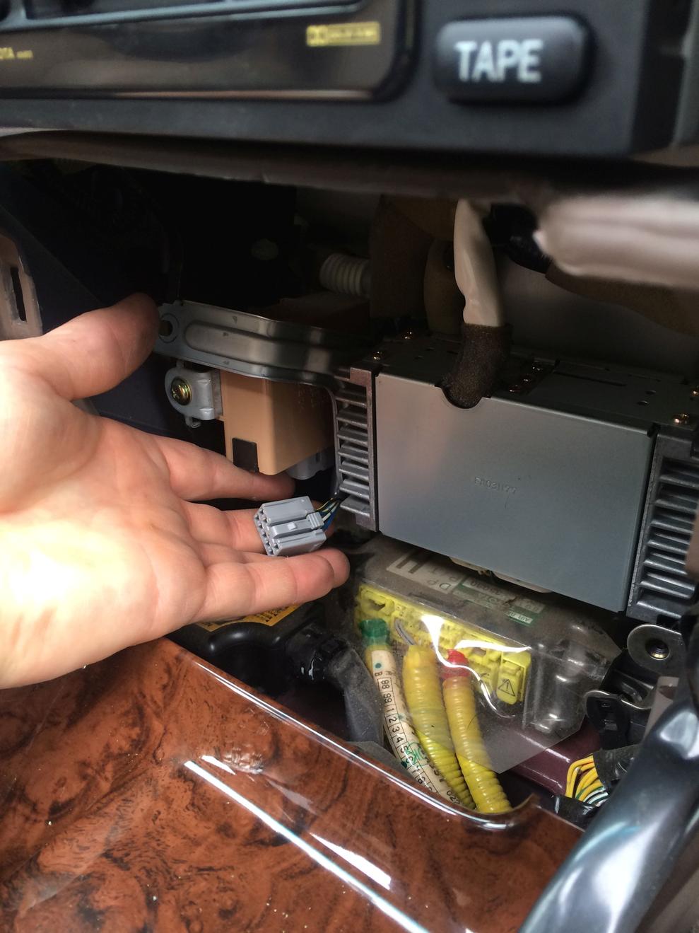

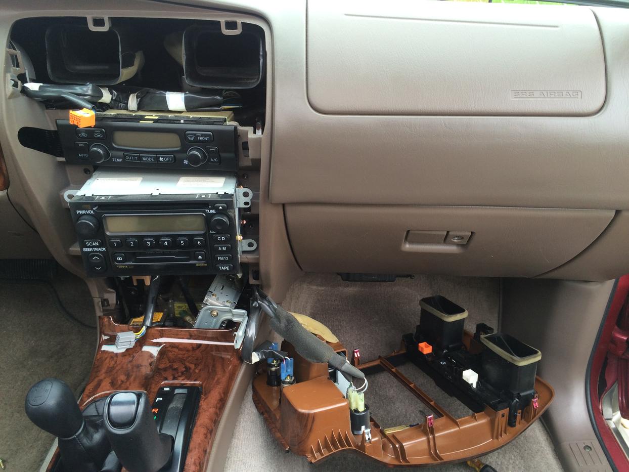

There may be a connector below your stereo that you can simply unplug. I did this right after I got my T4R becuase I had stripped gears and slightly bent antenna. After getting the antenna stowed in the down position, I simply unplugged it. Remove your stereo to make it easy. Mine is a 2000, this connector may not exist. Tear it off and take a look!
My index finger is touching the connector in the second photo.
