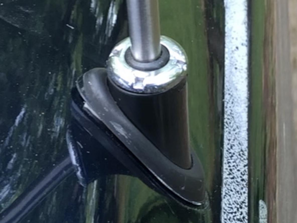

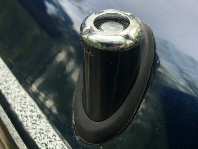

I opened the antenna motor and found some broken mast pieces. Removed those and put in the new antenna mast. It went in like a charm and retracted all the way down. I don’t have anything to compare It to since the original was broken. Is this what it’s supposed to look like when it’s all the way down? Included a picture for reference, seems too low. Also a picture when it’s fully extended. The seal is there and seems to be in the right spot. Any help would be appreciated.

Problem solved...for now
Well I was able to put a rubber spacer just under the rubber seal that came with my replacement antenna mast. Problem solved. I'm not sure why that was necessary but oh well.
