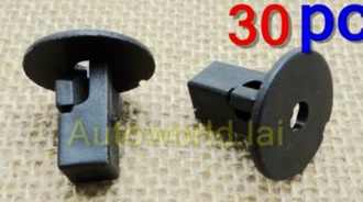

Grommet size for the wheel well liner
Hi guys,
For this job Im pretty sure from what I am reading that I am going to snap My plastic grommets in the wheel well liner. To buy them toyota is like $2 a piece which Im not paying. I found them on ebay for cheap, $4 for 30 of em, but want to make sure they are the same size. Check out the link below and let me know if they are the right ones.
30 Clips Fender Liner Screw Grommets Fit Toyota Tacoma Tundra Free Shipping | eBay
Thanks,
Mike
