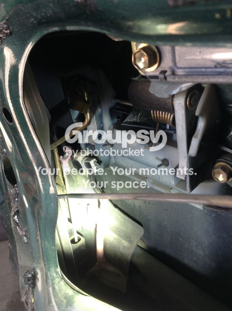

here is where I'm stuck.. the yellow 'keeper'

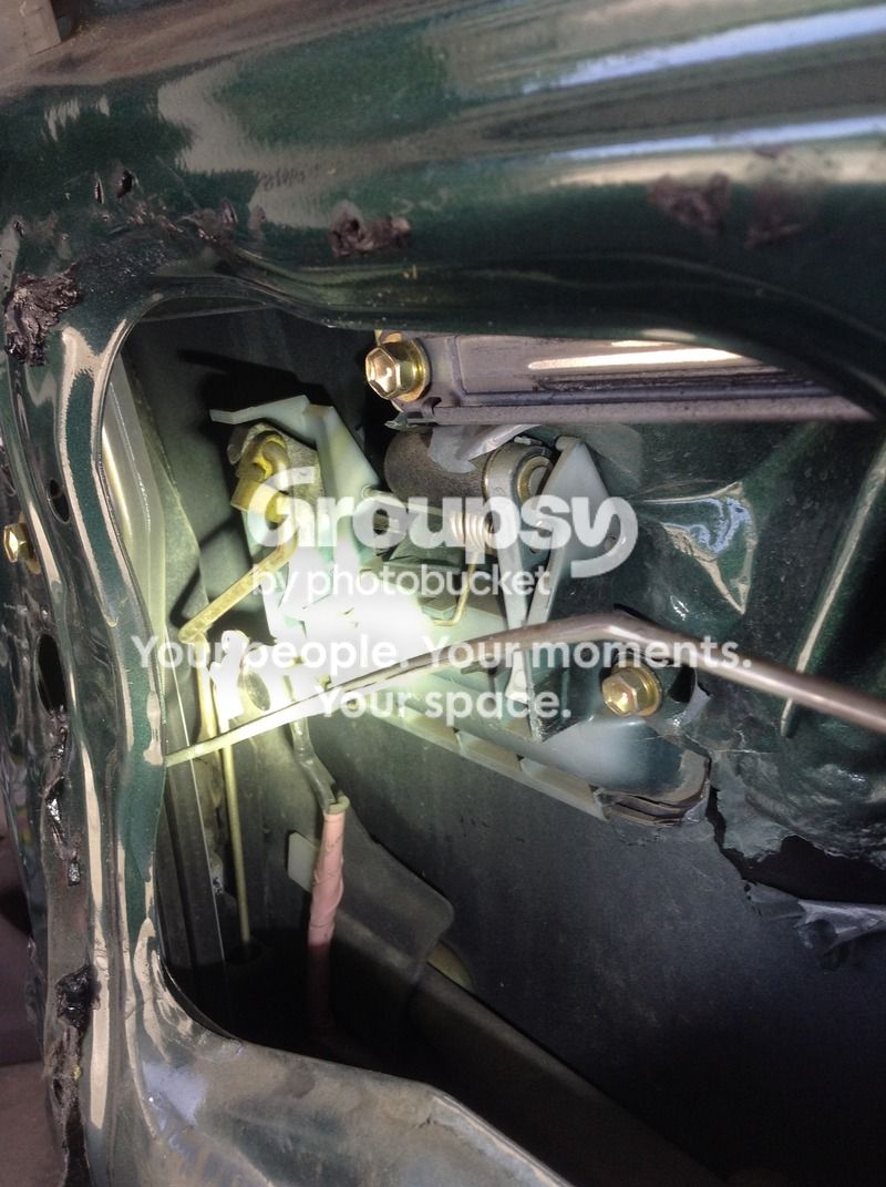

and the pink 'keeper'
how do i get these damn rods out???
The yellow one is ready, yes you have to pry gently, carefully with force. That's why those body shops make the big bucks! haha, actually we just ordered new clips and didn't waste time. They are like 3 or 4 bucks from Toyota!
