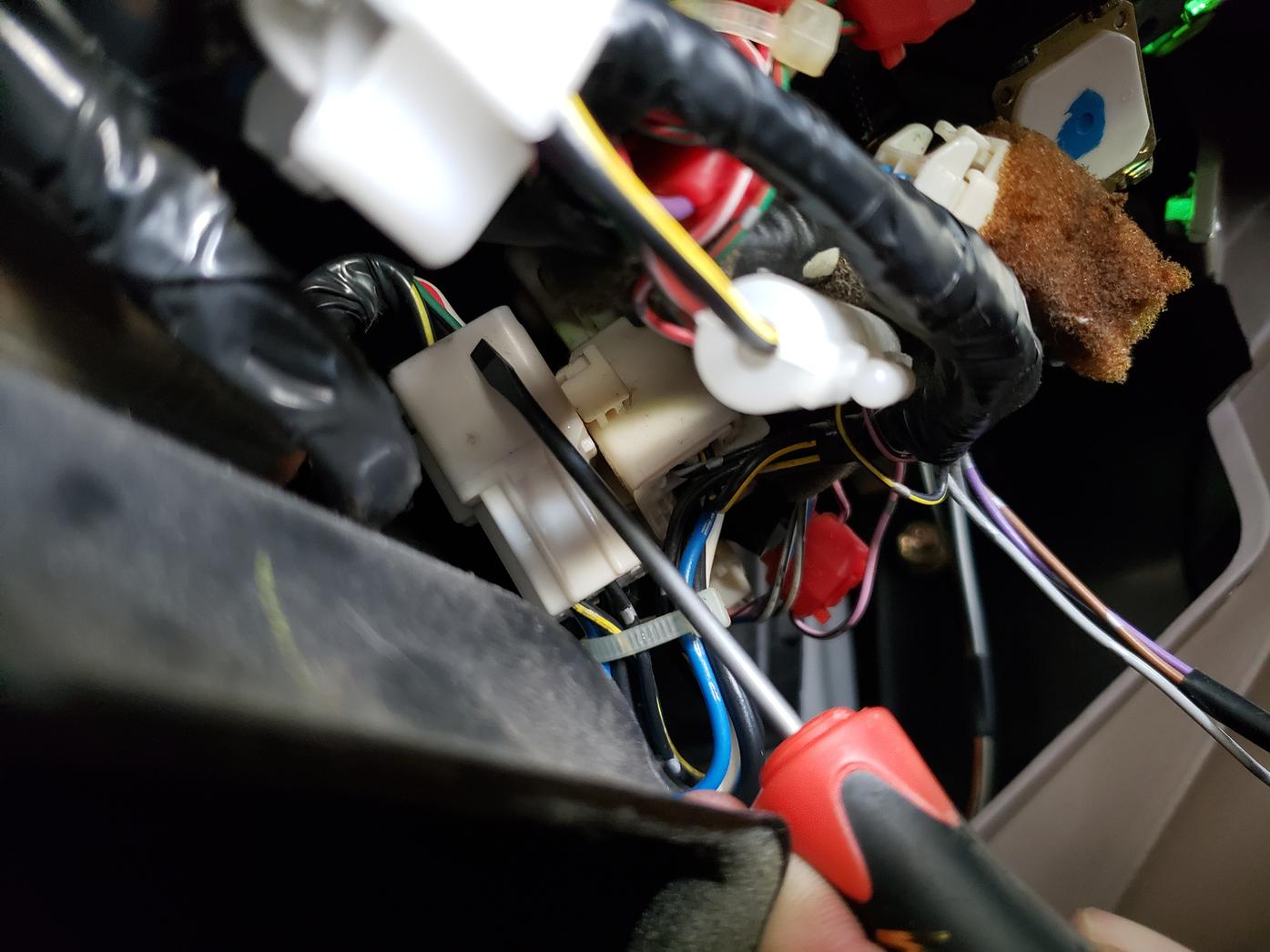

I'm getting closer. I went back at it today and it's something to do with the wiring harness and loom that runs under the steering wheel. I'm not sure what's bad yet, and there are a few splice connectors that I doubt are factory, they may be the culprit. It's nothing I did yesterday, just bumped existing wires.
It is fixed. It was super simple but hard to locate. It ended up being a plug to the ignition switch. It wasn't fully seated into the female plug end and was apparently just making enough contact to work fine, but when I ran the alarm sensor wire I must have bumped it. It's probably been like that since I've owned and longer. I haven't even moved anything in that area until now!
