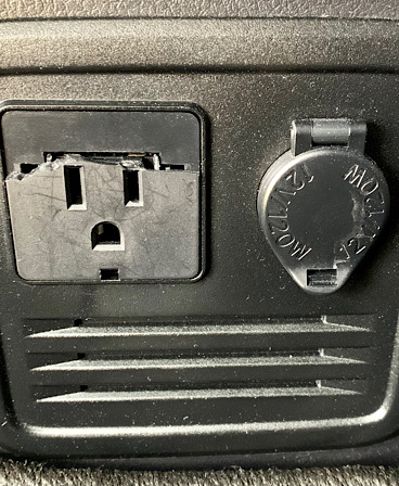

Have anyone replaced this part before?. Picked this truck up. And it has a broken power outlet.
Thanks for any input.

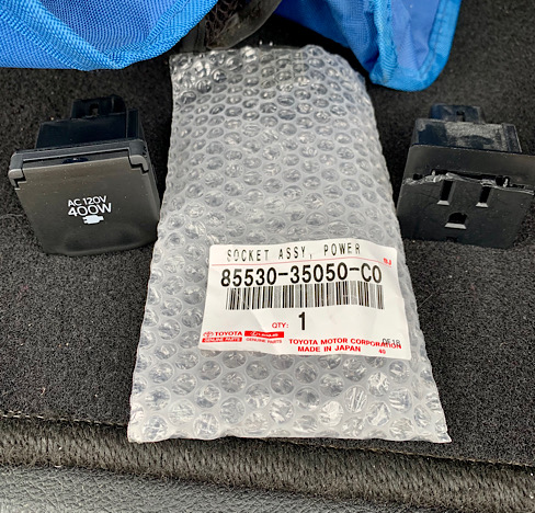

Are you looking for the part number? If so, the outlet should be 85530-35050-C0
Thanks for that. Well now with the part number I could find a pic. And it looks like it’s just a couple of pesky tabs.

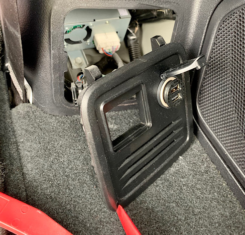

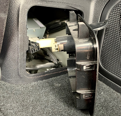

I just removed the whole tray. It came out with ease. Now that plug has 2 tabs on either side. And as I was removing the old one. One of the tabs broke off. They are really hard plastic. And kind of brittle.
Easiest is to remove the whole tray.

It's pretty easy to take out the electrical panel. Just a few tabs on both sides using a trim tool. After you take it off you can slip your hand into the opening and use a stubby philips head to undo the two screws on the top tray and simply pop it off. I did this to run wires under the wheel well area. FWIW I put the tray back on but did not screw it back in if I ever needed to access it again. It doesn't rattle or make any noises unscrewed.
Now the driver side top tray that's an entirely different question. I think if you wanted to remove the top tray without breaking tabs you have to remove that entire side cargo panel. If I ever have to remove that entire panel I'll be sure to remove those two screws holding the top tray.
