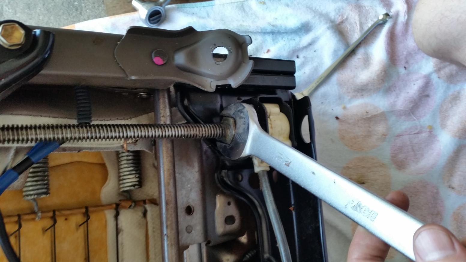

In case anyone is interested, you can also remove the seat and manually adjust the placement with a 22mm wrench. This is what I did considering I didn't want to remove the passenger seat to obtain the donor piece. Eventually I'll replace the nylon gear, but for now I just wanted to readjust to a comfortable seat position considering my step mom moved the seat all the way forward and of course thats the position it broke in.
Just make sure both rods are aligned so the seat placement is straight.
