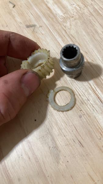

Has anyone had any luck with the replacement gear? The land cruiser one definitely doesn’t work, The tooth count doesn’t match.
Hopefully these pictures help, it’s a 2 part piece that’s solvent welded together
I went down the same road in 2015: tried the Gamiviti LandCruisier gear, and it wouldn't fit. I was able to find a donor gear from a used seat, and got it back together. I wish I would've measured the good gear while I had it off, and then I could provide a CAD model to you or Gamiviti. I guess I'll take the measurements of a good gear when it fails again!

I modeled it last night after I made this post.
(Or as good as I could on the actual teeth)
I was going to 3D print it in the next day or so to test. My idea was once I was sure my gear worked to actually print a female mold that the metal shaft fit into and cast the gear out of epoxy with a little bit of chopped glass in it.

I think it would be really hard to attach anything to the existing metal (other than by forming it around it); it has knurl marks like a barbell (you can see them if you look close). I can give heating and cooling a shot with the broken piece just for fun.
The reality is if I fail at construction then I’ll still be at square one. I think I’ll give it a shot and if it fails model the full thing as brass
Eureka!
Ok, I think I've figured it out, my prototype worked pretty well, the gear took power from the motor and moved the seat slide. Only issue was I didn't have the pitch quite right to manually adjust the seat with a 12mm wrench (overall, I'd consider it a win and "working"). Making a few tweaks and crossing my fingers it's perfect.
That being said if anyone needs any replaced, let me know. I'll probably put together a kit of 2 gears with instructions and post it up (I figured $30 shipped was a fair price to cover my costs).
