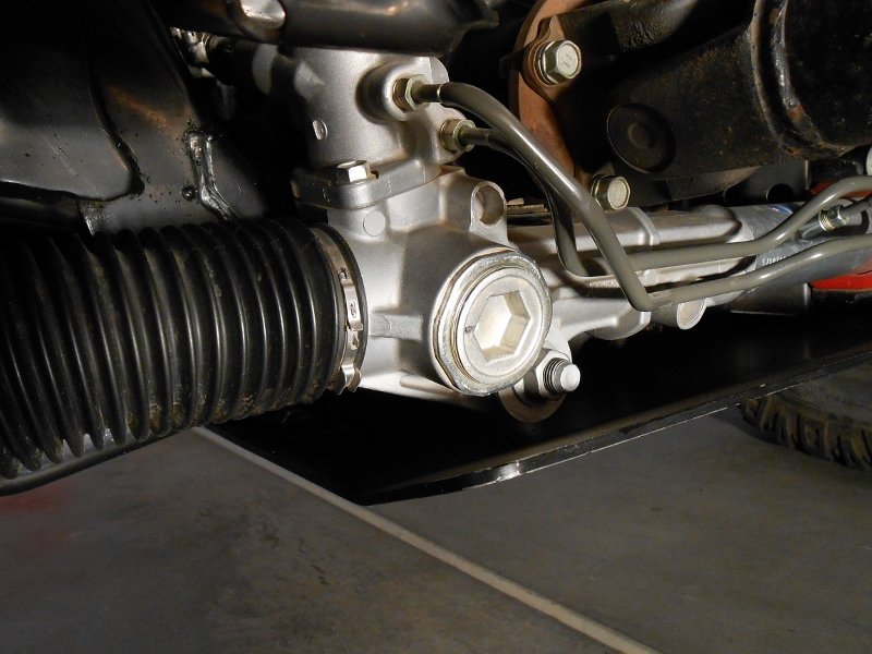

Hey guys developed a leak at one of my power steering rack lines, hard line on the rack. I am going to dig into the forum to try to find some answers but would love to know if I can just replace the lines and not have to do the entire rack. Of course trying to loosen the flare fittings was tough, the one side with both flare fittings next to each other, hard to get good torque. I dont have a pair of flare nut wrenches but may have to run out tomorrow and get a set for this.
Thanks in advance.
Turn Pressure tube in the diagram below, and the lines in the picture below.
Thanks in advance.

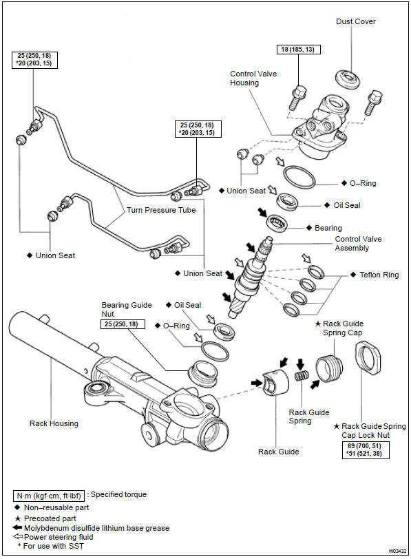

4441835050
TUBE, STEERING RIGHT TURN PRESSURE
4441935050
TUBE, STEERING LEFT TURN PRESSURE
also looks like you need a couple of these, not sure but it seems like a crush one time deal to me?
9041004002
SEAT, UNION(FOR POWER STEERING RACK HOUSING)
FRONT STEERING GEAR & LINK | 4RUNNER VZN185L-GKPZKA RZN18#,VZN18# | Toyota | Genuine Parts Catalogs | PartSouq Auto Parts Around the World

You can only get these tubes from Toyota. You might be able to fabricate them, but it's all metric and might have weird ends on them. The easiest way to get fittings off when you are replacing the line anyway is to cut the line off and use a socket on the fitting.

Good to know there is another source for these, but they're like $50 ea from Toyota.

If you can get them for $50 I'd like to know where. When I priced the high pressure line it was more like $330. So I went with an aftermarket (Sunsong) line. It was well built and the bends all matched perfectly. I did put a coat of silver rust oleum on it to help with rust.
Olathe Toyota showing prices of $51.00, $28.00, $4.71 for these parts.
Dealer local to me will match any online price so I'm good for a $100 fix.
I just called Jaffarian Toyota in Haverhill, MA and they actually said the lines are NOT available at all, serviced only as part of the rack. Weird because I see them online for like $50.
for fun I checked the two Toyota dealers I use for parts, and both show available, and yes for approx. 100 for the pair
For the hell of it I called local dealer I buy from, hard lines are in the States can be had along with unions at online prices. One line two days out, other and unions 2 weeks out, normal for back order.
Oh man I was talking about a totally different line set. I misread the OP's post and thought we were talking about the lines from the power steering pump to the rack, not the hard lines on the rack itself. yes those are totally different.
