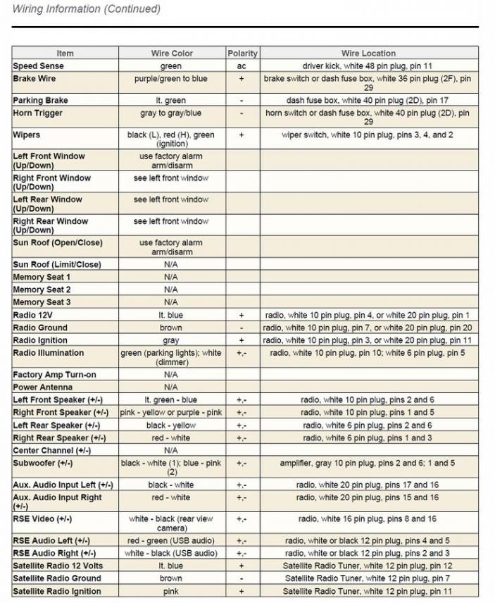

I purchased a Kicker HS8 Powered Sub. I am ready to run the wiring but I am not sure where I should tap into for the remote power/turn-on. I have a 5th Gen non JBL w/nav. Below is a wiring sheet I found online which seems to be fairly accurate. There is no Factory Amp or Power Antenna values which leads me to believe there may be non to tap in to. Where could I tap into for my remote power without affecting the performance of anything else?

What about the last one, “satellite radio ignition”?
It would be switched power...
I would want to verify that that is 12V and I would want to assure that that would cause no issues with my satellite radio because I use that often.
I currently have the same powered subwoofer mounted under my driver's seat. I bought the Kicker RCA adapter and a Toyota wiring harness adapter. This makes it a little easier to hook up and you won't have to splice into any wires in your factory harness.
I also mounted the remote bass controller into that small compartment in the center console. I'd still like to swap out some of the other speakers but so far I'm pretty happy with the sound after adding the Kicker subwoofer.
