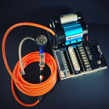

Does anybody have that specific powertray with the ARB compressor installed on?
- Is there enough clearance under the hood to put in the T junction with the quick disconnect and the pressure switch? The photo on the website seems to be using additional pressure hose and connectors to attach the disconnect to the board. I am more interested in simply attaching the disconnect on the top of the T to the manifold.
Note that to fit in the space, the compressor cylinder needs to be inverted compared to the config it is sold in and the manifold put flat to maximize the space above (the way it is on the photo below)
- Any issue with the compressor vibration and any impact on the electronic part?
Thanks
Eric

Which model ARB compressor is that? It looks tiny, like the one used for air lockers.
Vibration would be my only concern, but that thing is solid state for the most part, probably fine, but I can understand the want to move it somewhere else.

I do not have the plate but I do have the same compressor mounted in the same general location in engine bay with a custom mount. As you stated the manifold has to be rotated to clear hood, but the pressure switch is under the disconnect on my install.
