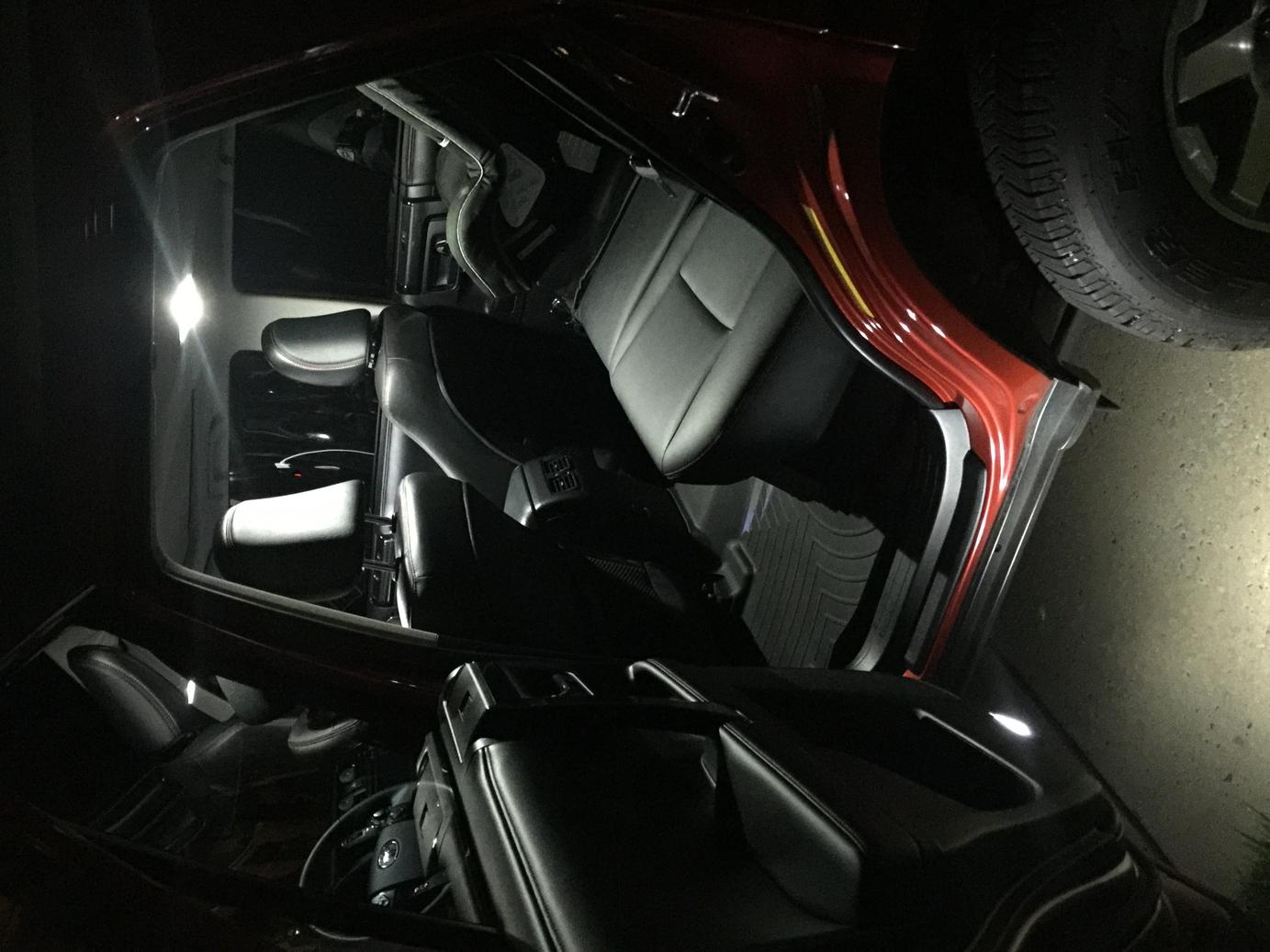

I went with the 8k precision led kit and it's amazing. Bright like the daytime...all the time.

They may have said 8k, but that is not 8k (lucky for you). I would say 5-6K tops. 8k would be purple and not put off as much light. IMHO yours looks very good.

Man, there is no need to be like that. This is a place to help people, and we appreciate that you took the time post a picture and comment. We happened to catch that the lights were not 8k (at least not in the picture). If someone sees your picture and thinks 8k looks pure white and decides that's what they want to buy, they are going to be disappointed if real 8ks show up and they get purple.
Please understand it not you that we are against, it's just the misinformation we addressed.
