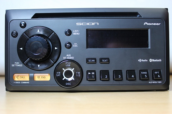

Which model number did you get? This sounds like a great idea.
How much hassle was it to mount the head unit?
I have an 08 model that I bought from CL, like this:
But I recommend the newer than 2011 ones that has more rows of text on the LCD display, as it's easier to scroll when searching on your Ipod similar to these.
As for installation process. The only thing I had was a metal file, which I used to file the left side of the center trim coverings. I did a little too much since I was in a rush to have it on, but it's fine with me. If you are a perfectionist, you could fine sand it.. but I just went right to fit and finishi within 30mins. with plug and play of the music. All that while my two little girls were climbing from trunk to back seats playing around.
