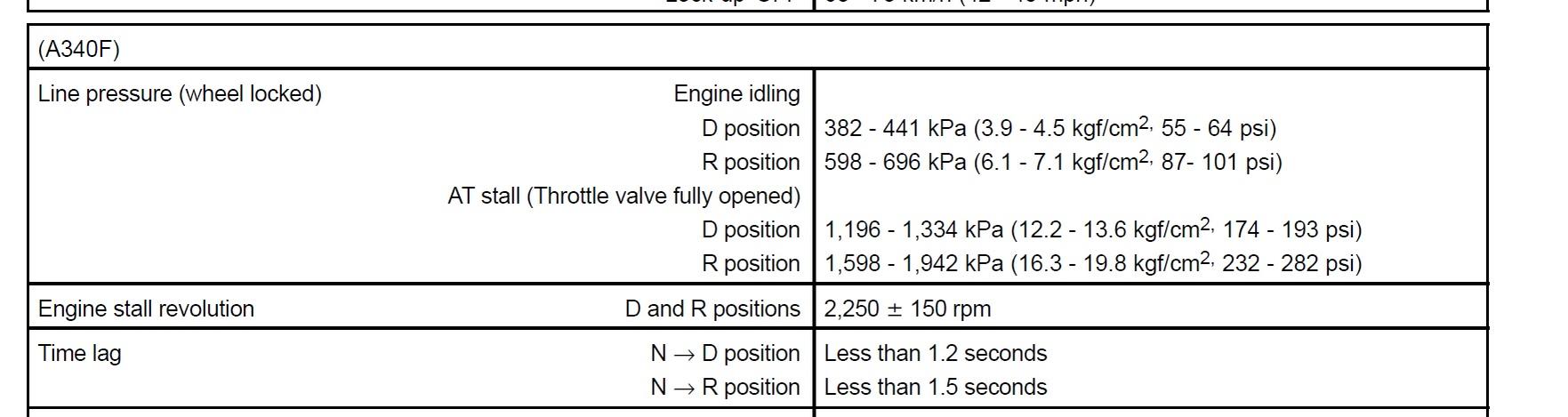

As said, should not be much of any pressure unless there's a blockage. But the trans does build some pressure.
