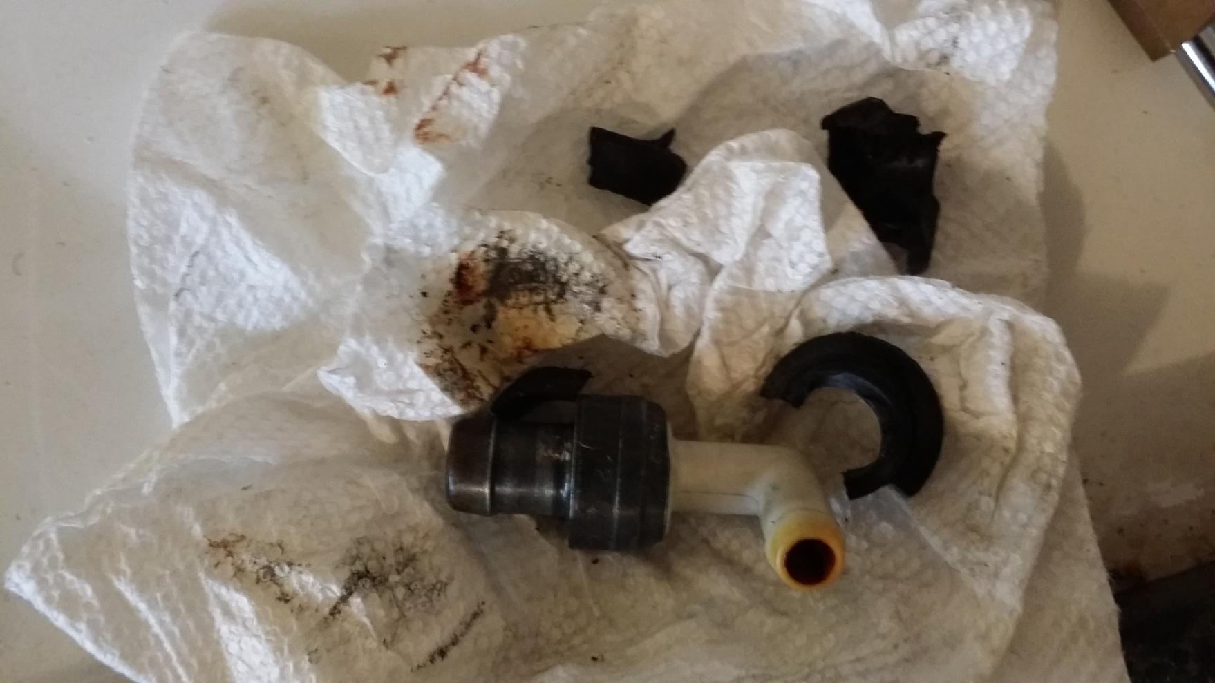

Oh and on that pcv grommet be careful getting that out it's probably brittle. If you do the throttle body this will be a little easier with it and the cables out of the way. I "sawed" mine while it was still in with a small xacto which helped and then tried to pull it out with small pliers and a lever tool down on the inside lip. Even so it did crumble and one piece went down in there but I was able to get it with my little grabber tool. It's flat so if any pieces drop in there you can (and obviously should) extract them. Just know that can happen. I put a little grease on the new one but after 100k miles that's just what happens to plastic. For me it was more that hose was cracked on the edge so I got a full kit with grommet, hose and valve...oem on eBay $20.
just did my pcv valve and grommet. it disintegrated. nothing a pick tool and shop vac can fix.
