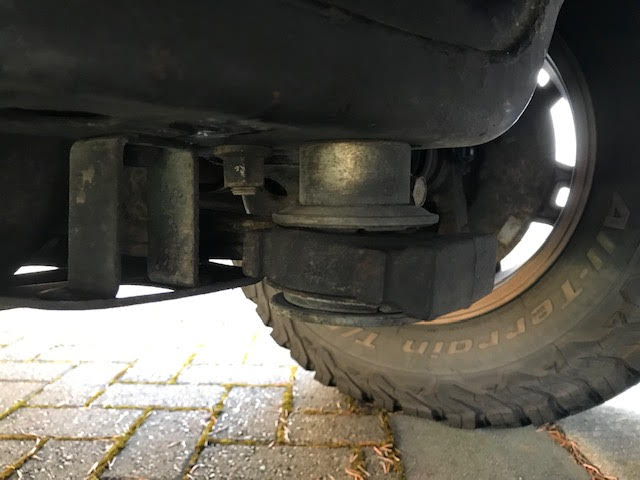

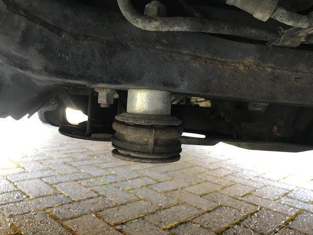

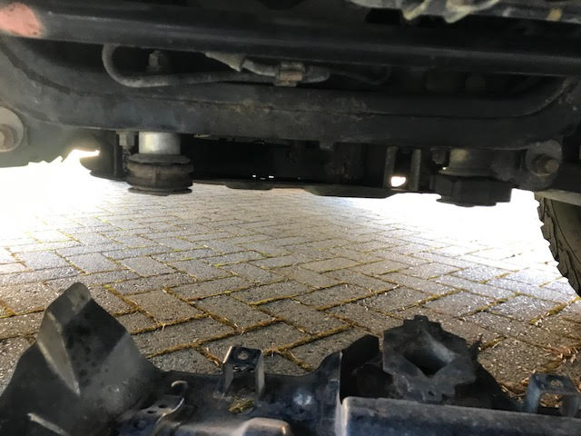

I was poking around under the car and noticed this, which I haven't noticed before. Is this some type of leveling kit or front spacer? If so, any other spots to look for other installed parts of this potential kit?
Secondly - what's up with the difference in rubber between the two sides?
Thanks!

Looks like a diff drop spacer! As far as the different bushings, I believe thats how it is from the factory. Nothing to worry about there. Wouldn't know if the truck has a lift/level unless you upload a picture of the coils/shocks in the front wheel wells.
I'm guessing if someone did a diff drop they likely have a ride height modification somewhere! It is designed to help the geometry of your CV axles in the front, but I have seen evidence that it doesn't really help. Doesn't really hurt either though from what I have seen.
