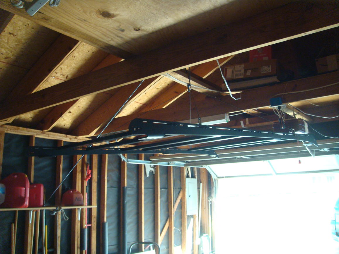

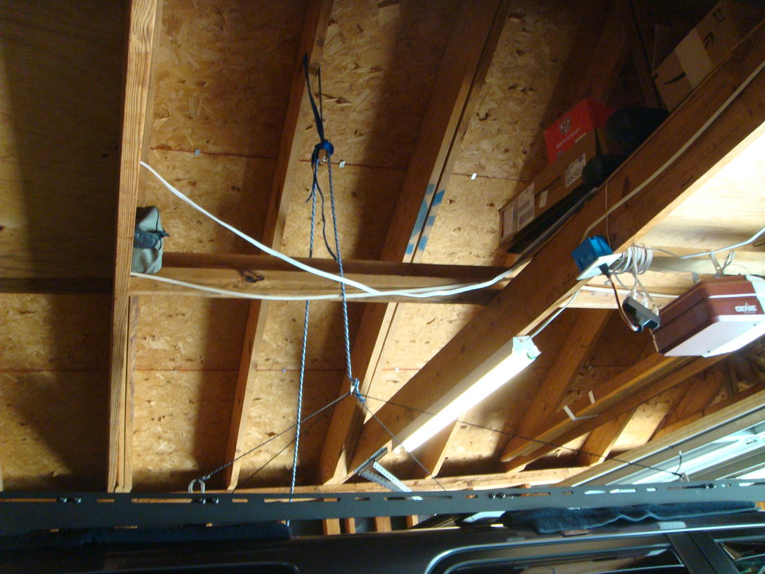

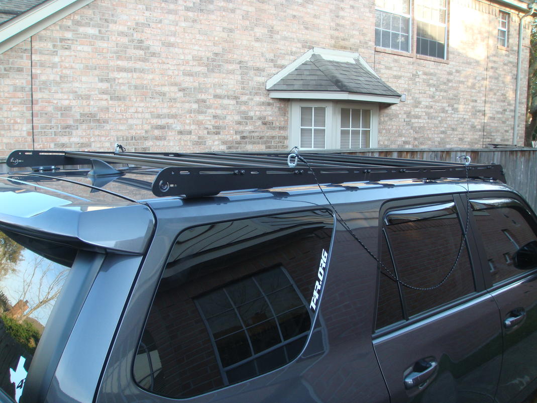

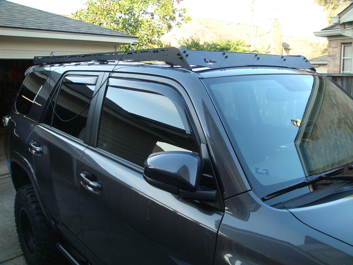

installed my rack today on my runner, this thing is badass. The install is pretty straight forward, i did put some anti seize on the screws and they felt much better going in. It's definitely a two person job, Didn't have anybody to help me lift the rack, so i had to do it redneck style. there is a bit of wind noise going down the highway but hopefully when i get my rubber trim it'll quiet down a bit.

Drooling over here! Nice engineering job on lifting rack in place. Too bad Prinsu design didn't do more testing with wind noise but hopefully the rubber trim will help. Would make nervous personally having rubber trim touching paint and rubbing with micro vibrations. Then again my tailgate 4runner logo has ruined paint and have rust all over it and Toyota won't warranty. Can you stand on top of the rack now?

there is some clear film that you can get to prevent the rubber trim from rubbing on the paint. i'm sure you can stand on it. the crossbars are removable you can just put a few or you can put as many as you want so you can walk on it.
the rack is very versatile you can have as many or as little crossbar as you want. the crossbars have "tnuts" that you can slide the lenght of the crossbar for tiedowns.
