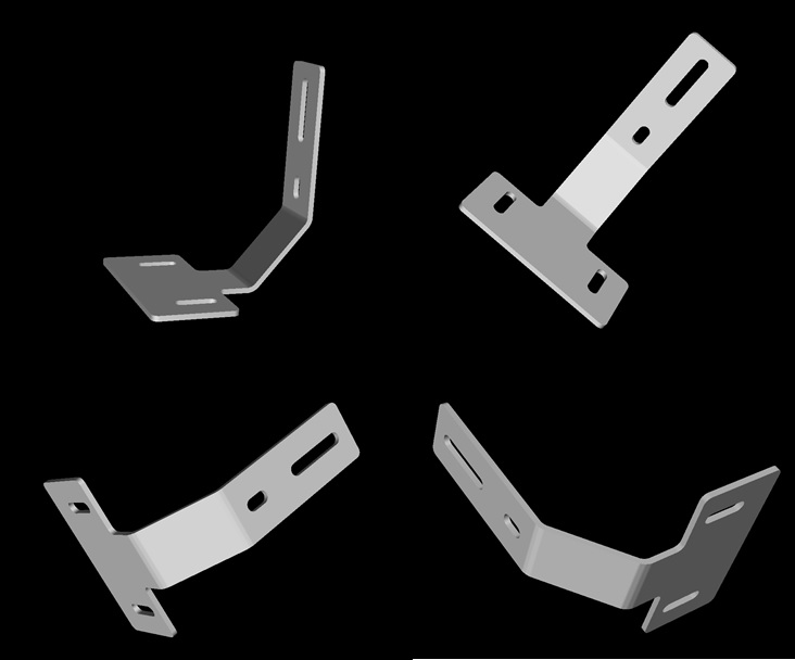

Hey guys, I shot Eitek1 the CAD file. eMachineshop does everything including the bends, machine work, and powder coating. Obviously the higher the quantity you produce the lower the cost. I imagine the material to make them costs next to nothing so I dont doubt Eitek1 could make them cheaper if he has access to a machine shop. They are made from 6061 Aluminum and are 4.5mm thick. The bracket sits at a 90 degree angle overall, with the upper bend at 40 degrees and the lower bend at 50 degrees.
Here are a couple of 3D images from the eMachineshop.com software. You can download the software for free from their website. For an amateur tinkerer like myself the website is really cool for coming up with ideas and being able to visualize them in 3D.

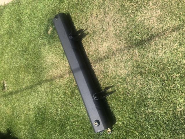

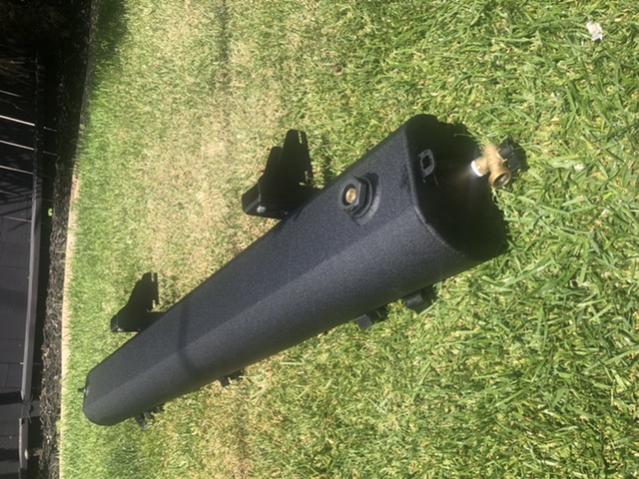

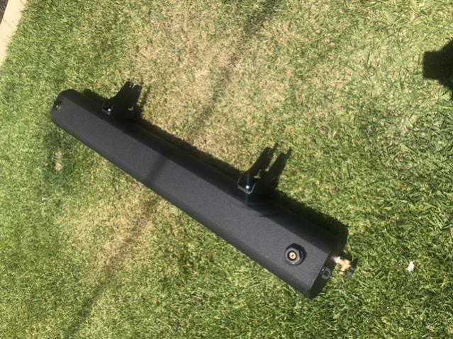

Here’s a few photos of how it sits when it is stored. Everything is ready to go so when I need to use it again all I do is pick it up and lift it onto the rack.
Some of you will notice that I had mine re-powder coated because I hated the blue road shower lettering.
