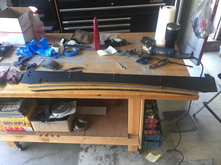

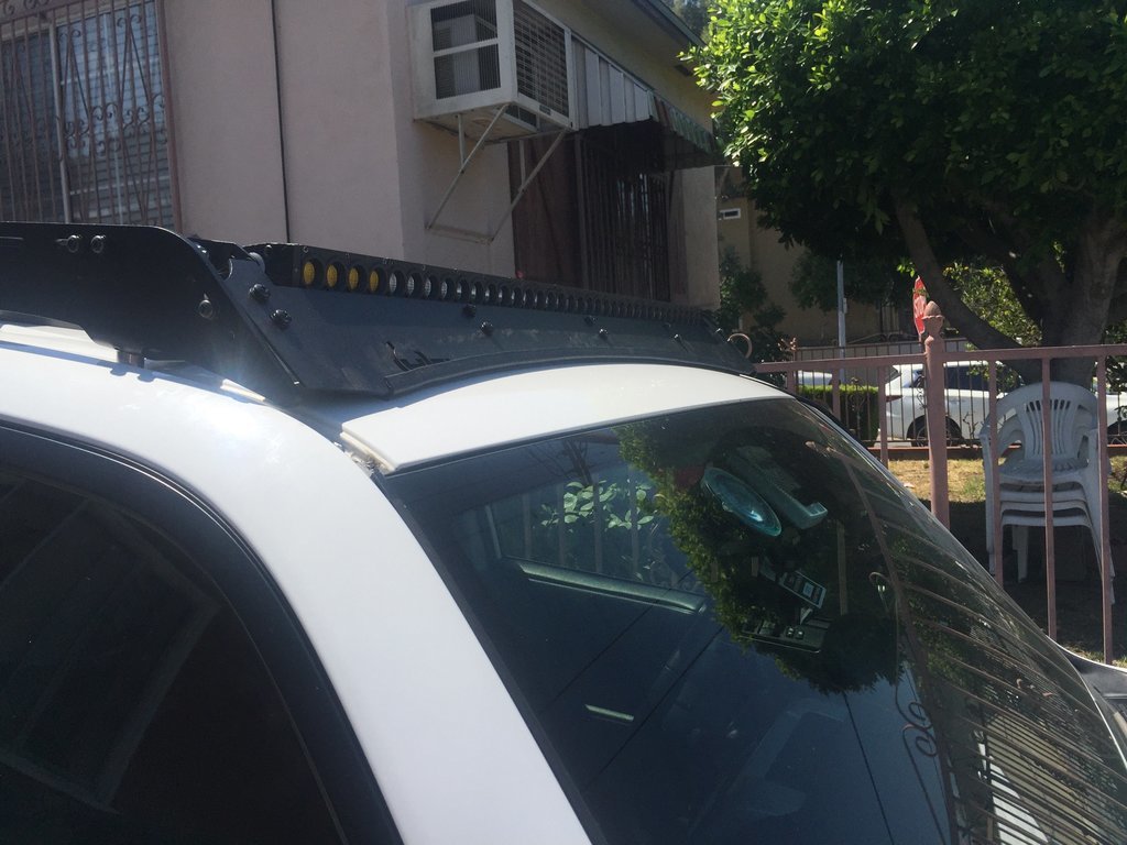

First, we tried to lower the wind fairing to the lowest setting so that the light bar behind could shine through the cutout. The problem was that the fairing would contact the roof so it could not be lowered past even the highest position. My friend decided that we could cut the fairing. It took a couple of tries, but we ended up cutting 13/16" off the bottom of the fairing. Great idea, would work great but if you use the bar that comes with it, the actual bar touches the roof. So there is no way to put the bar on the lowest setting even without the fairing.
Luckily, Prinsu provides a single bar for the very back of the 4runners since the sharkfin antenna gets blocked without it.
We bolted the fairing to that bar and mounted it up. Worked fine and the lightbar just barely clears. Overall, a success!
It would be a lot cleaner if we didn't have to cut into the logo, but we had no choice. If Prinsu designs this properly, they can make it so the logo is clean and sits in a different spot, as well as allowing 4runner owners to run lightbars cleanly without having to cut their new rack or have the lightbar sit above the rack.

This one shows the pieces cut off.

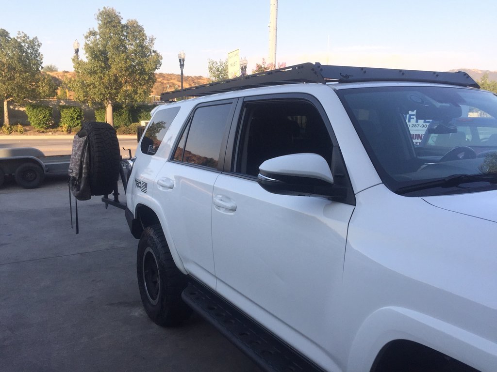

I think the Prinsu looks like parts form home depot slapped together (again personal opinion) I would like FR more it the rack were thinner.
I like that Prinsu is lower profile. FR was 6" tall where Prinsu is 4"
I live in LA so Parking structures matter :/
I think 3/4 rack FR looks better, but full length, Prinsu looks better.

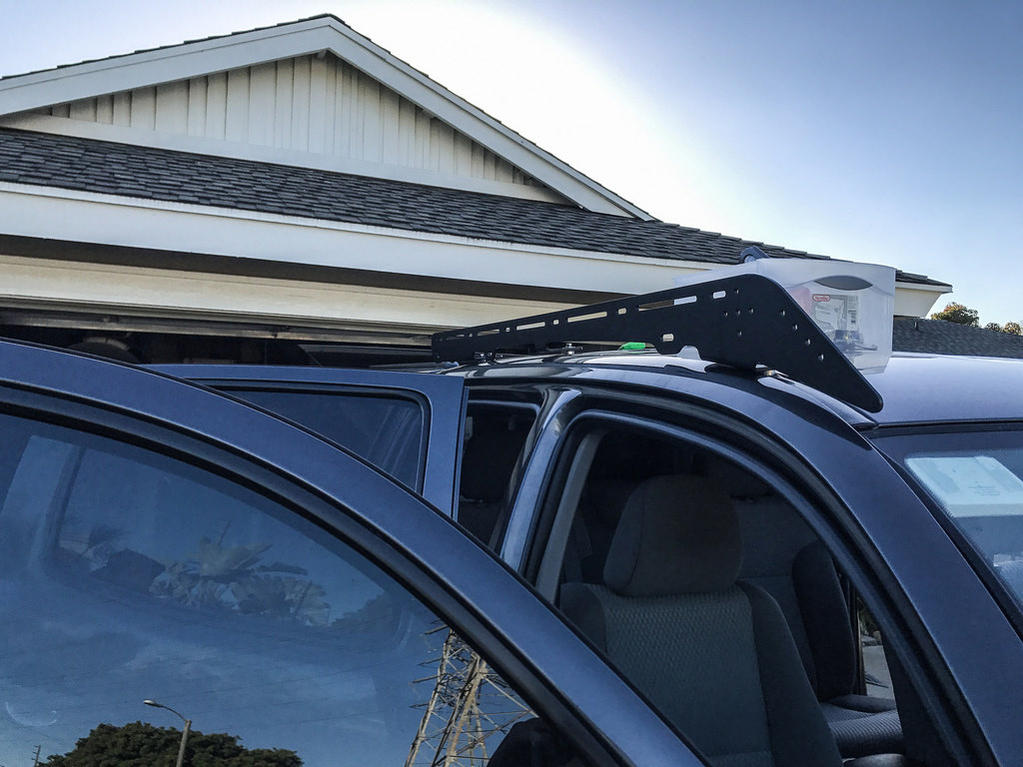

OP, I'm confused about your comment regarding the lack of awning mount compared to the Tacoma. Are you referring to this?
www.prinsudesignstudio.com
No. I'll add a photo in a moment. The Tacoma racks have slots about 3" lower than the slots that the cross bars go into to allow you to mount an awning really low profile with no extra parts. Not a big deal, just odd it's not included.
[MENTION=166861]SNOW_TRD[/MENTION] see here.
There are two slots near the roof line that are intended for bolts on an awning.
