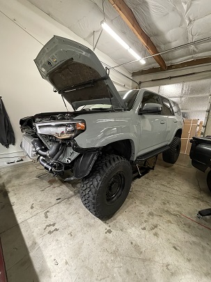

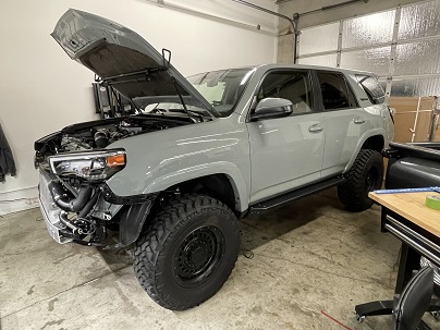

Update 10/9
UPDATE: HP Tuners still has the ECU, eta is still a little unclear but I am expecting to hear back on Monday or Tuesday regarding the status of the tune.
I think I have decided on the 3.5 Long Travel Total Chaos Kit. Going back and forth between having coil-overs built for me or ordering the kings set up. We will see on that.

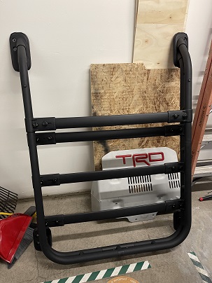

I finished up the Victory 4x4 Rock sliders. They don't fit quite as nicely as I would hope. the tolerances are a little off giving uneven gaps but its close enough to where I don't think it will be noticeable to anyone but me. I am half way done wiring up the led lights located in the rock sliders to the switch pro. I removed the TRD Pro roof basket and it is available if someone is looking for one... DM for price and details.

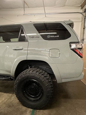

I acquired a vinyl cutter! I made a vinyl instagram banner for my rear windows... color matched in lunar rock vinyl :bounce: I have some more cool accents coming... Excited to share them.
