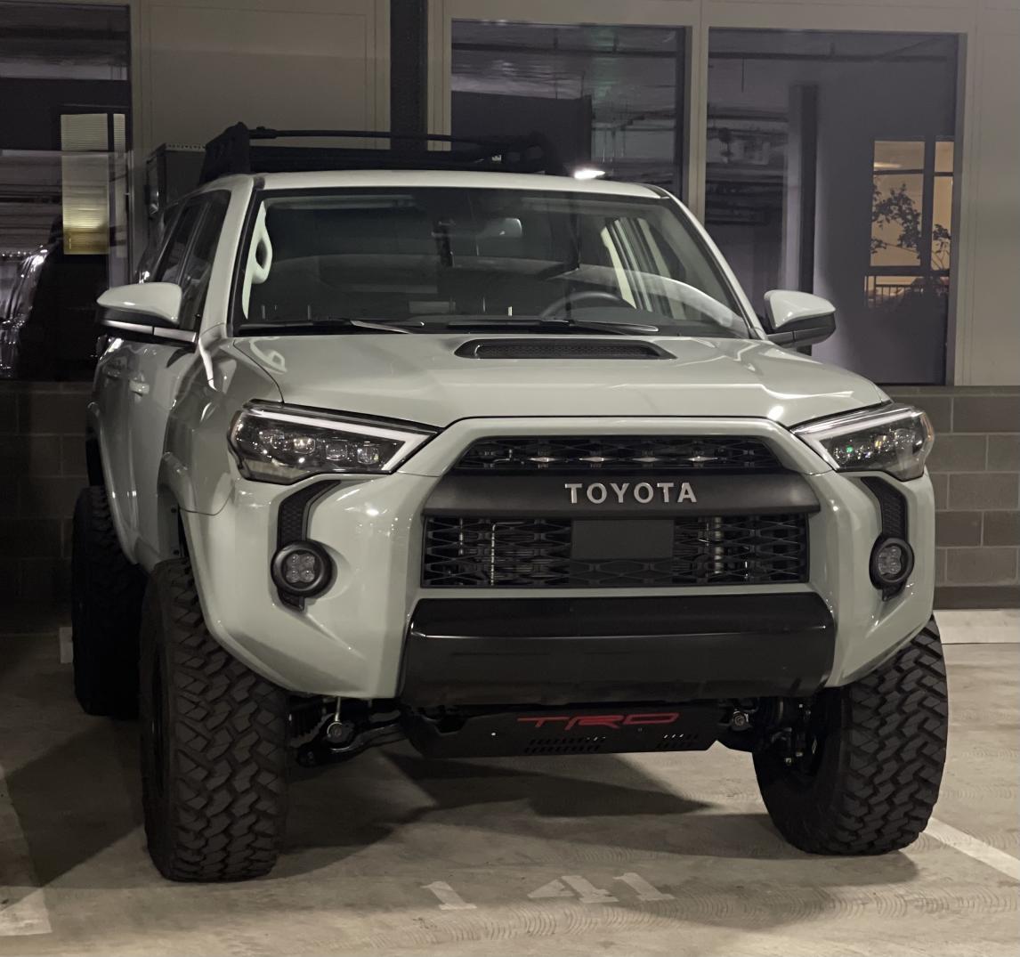

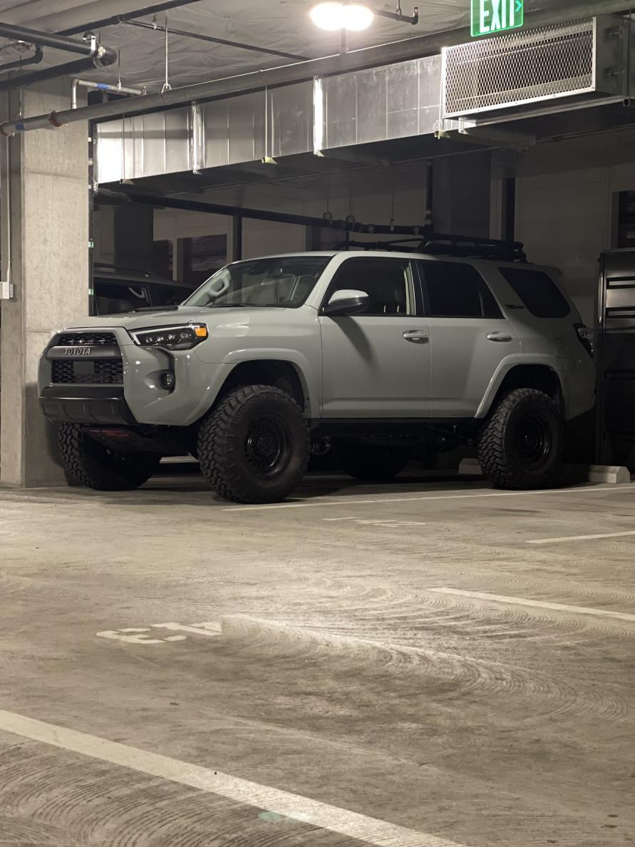

I recently added a 2021 TRD Pro in Lunar Rock to my 'garage' for the purpose of building my ideal Overlanding / Offroad machine. I wanted to build something unique to my interests. I have a shop where I work on my odd collection of vehicles. This adventure started with a 2018 SR5 for a base build platform, but when I had the opportunity to acquire a Lunar Rock TRD Pro I jumped at it. This thread will be updated as items come in. Happy to answer any and all questions! Some various components may have youtube install videos available.
Current Build
Wheels & Suspension
33" Nitto Trail Grappler Tires
17" KMC -12 Offset Wheels
1.25" Spider Trax Spacers x4
3" Bilstein Front Suspension Lift
3" OME rear coil spings
Power Mods
ATI Pro-Charger Kit w/ straight cut gears (Black Housing)
Pedal Commander
Lighting
Alpharex - NOVA Series LED Projector Headlights
Diode Dynamics white Fog Lights
Exterior
Factory TRD Skid Plate Painted Black
Interior
ICS Fab Dash mount w/ USB Chargers
Victory 4x4 Center Console Molle Panels
Victory 4x4 Overhead Molle Panel
Victory 4x4 Rear Window Molle Panels
Victory 4x4 Universal Shelf
Modified BPF Dog Barrier Molle Panel
Teton Workshop Gear Selector w/ white accents
Overlanding Gear
Alu Cab 3.1 Expedition Tent
Parts on order / waiting for delivery / waiting on install
C4 Low Pro Winch Bumper
C4 High Clearance Cut Trim
Victory 4x4 Strike Rear Bumper w/ Baja Designs White LED lights
Victory 4x4 Blitz Rock Sliders 1/ white LED lights
I order parts everyday! Game plan is to do a stage 7 Icon suspension, -38 offset Stealth custom series wheels, and a load more overland recovery gear.
The 4runner is currently dead in the water, waiting on tuning support for the 2021 ECU. While it is down I am driving my white SR5 recently upgraded with TRD pro suspension :tongue:.

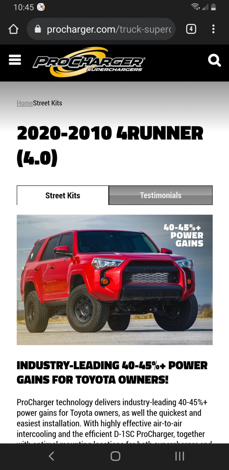

Keep us posted on the tune. Probably just an editing error, but ATI website shows the kit fits a 2020. I realize 20 is a new ecu, so its a bit of a let down.
I can confirm that is an error on their end. They do not have support for anything past 2019.

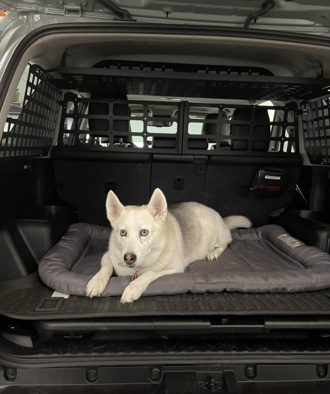

Interior Puppy management
My interior puppy management system or IPMS… consists of a series of molle panels that I lightly modified to work together. I do have a harness system that attaches as well (not photo’d) It is currently in my SR5 because well… the Pro is not currently driveable. The side panels and shelf were sourced from Victory 4x4 and the dog barrier is a cut down version of BPF’s dog barrier. It works great, and it does not rattle or vibrate. Highly recommend for your IPMS, also offers great storage for recovery and overlanding gear.

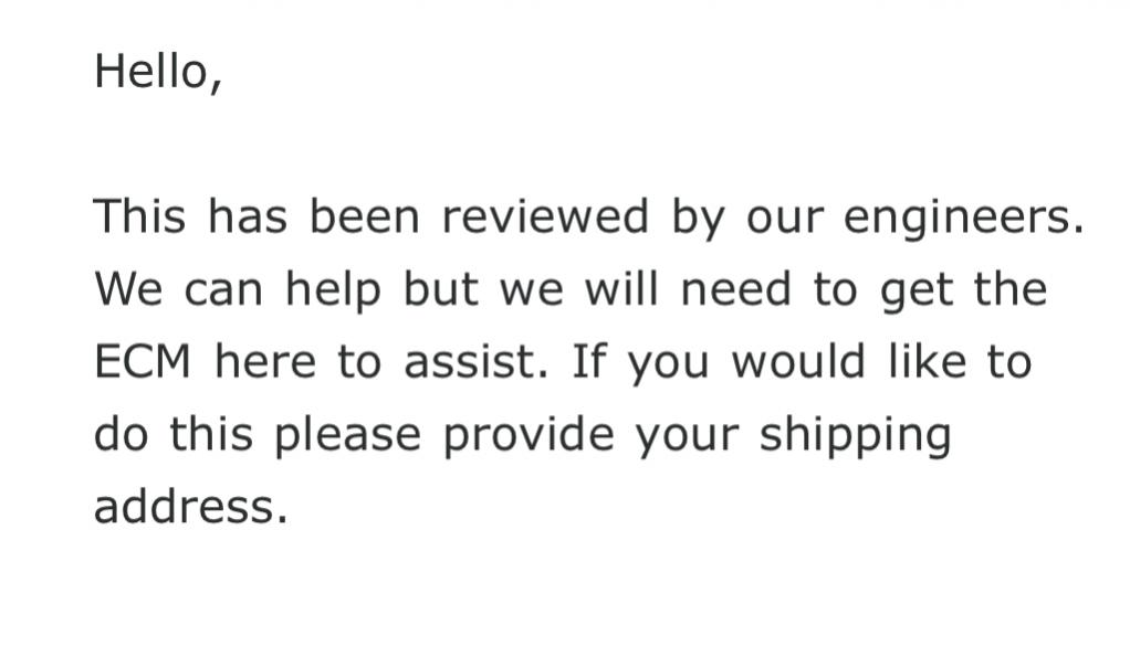

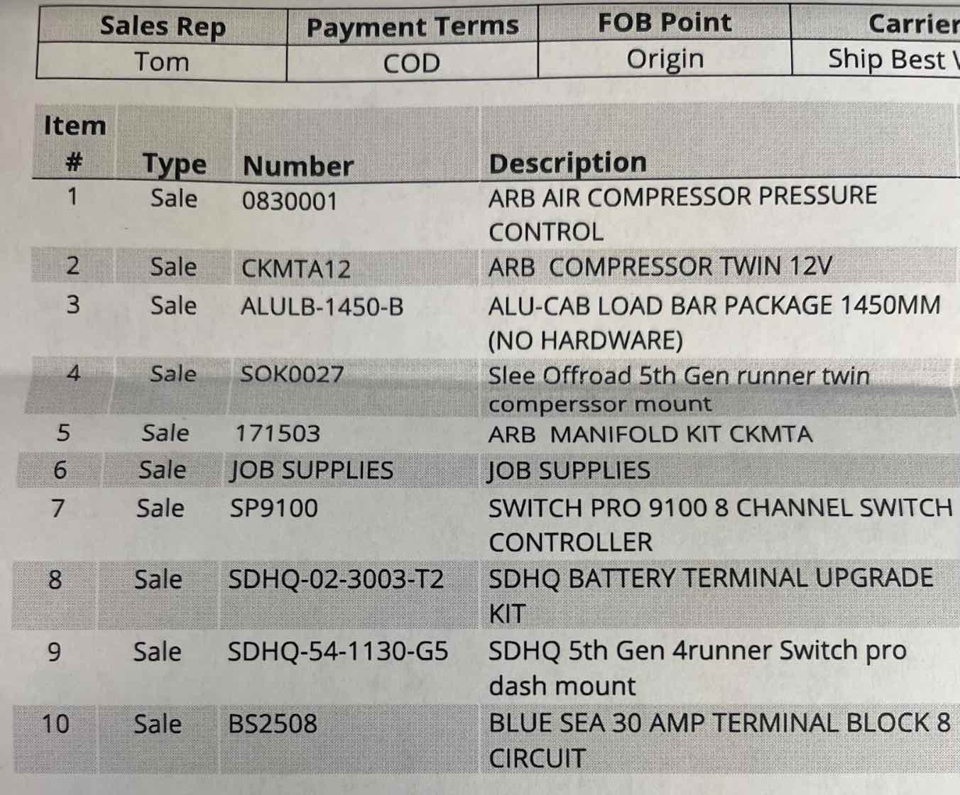

9/29 Update
I visited Tom at Mule Expedition Outfitters today and picked up a healthy parts list for the build. MOST IMPORTANTLY I heard back from HP Tuners today, looks like we are going to have some tuning support. Nothing is for sure but... this looks promising... :lock1:

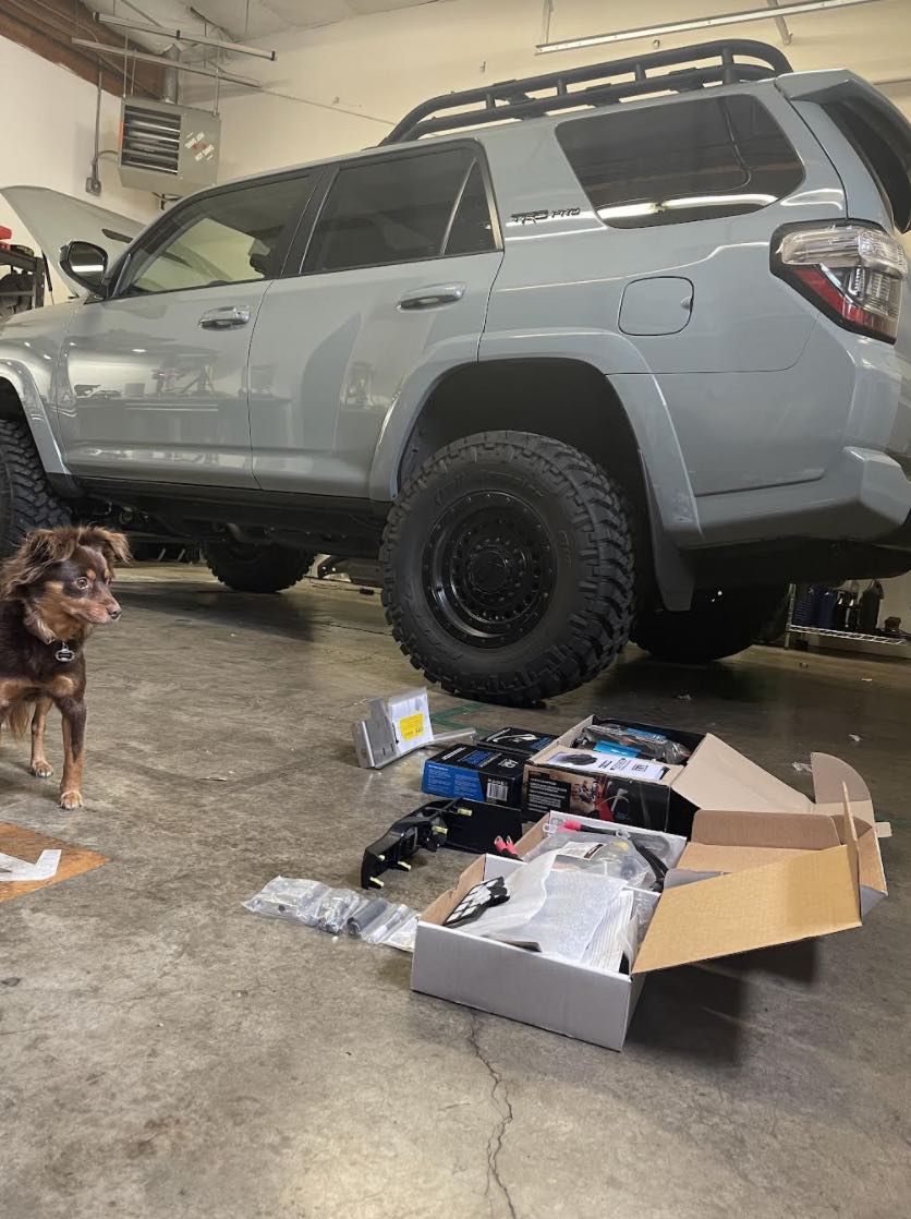

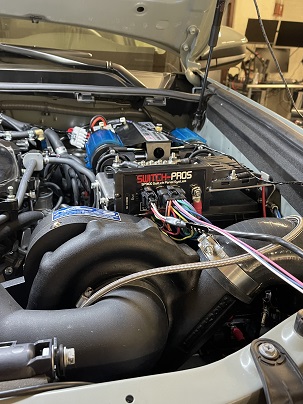

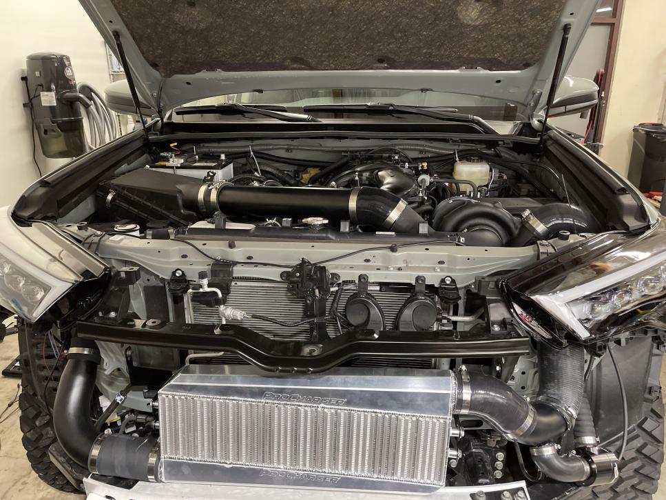

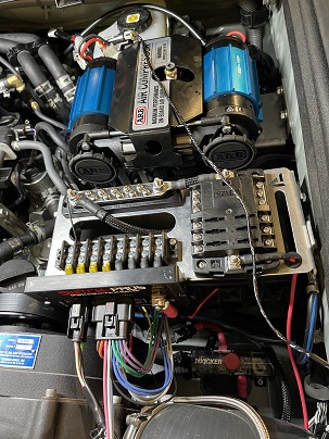

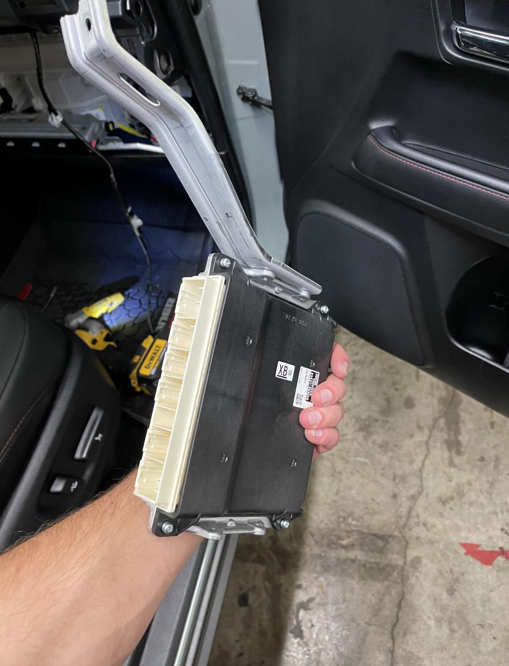

update 10/1
HP Tuners has my ECU and the engineers are working on getting my ECU flashed. ATI / Procharger is very excited, because by all indications tuning support for the 20-21 4runners is here. I am holding out on saying that tuning support is available until I receive a tuned ECU back.

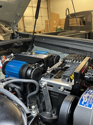

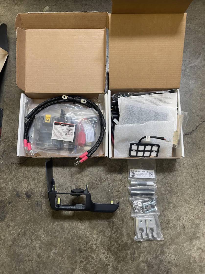

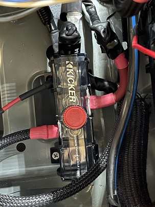

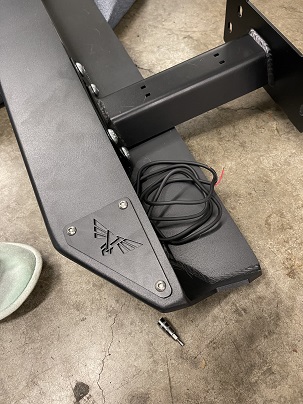

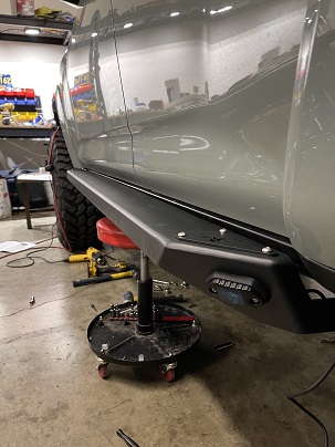

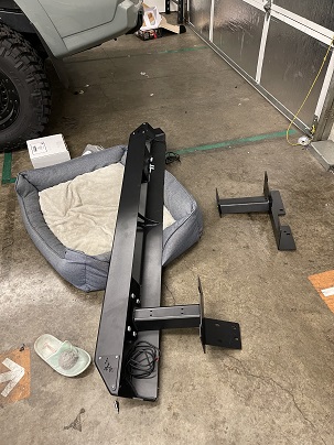

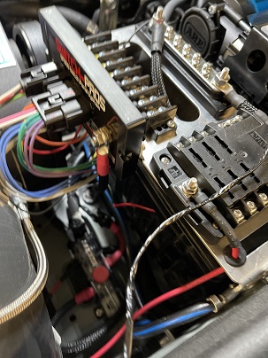

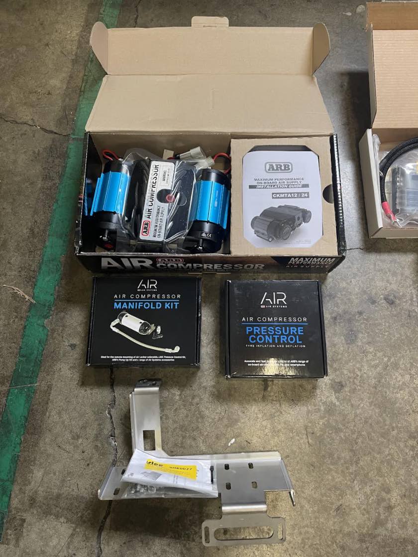

In the meantime. I finished up (mostly) a tandem ARB twin compressor / switch pro install. I also have started the Victory 4x4 rock slider install. Ill upload photos of those projects. The switch pro install was a little more complicated than usual and require some brackets to be made to hold it in place above the fuse box. I flipped the slee bracket bracket around and made some basic mounts. This allowed me to mount both the switch pro and twin compressor. Due to the procharger install requiring a relocation of the battery to the passenger I had no other space to put the switch pro.
I have some big plans for the onboard air system. I am excited to share that soon! Big things coming for the Lun4r build!
Nice! So they were able to install the supercharger and tune the 2021? Looking forward to your review of the power upgrade.
I did the procharger install in my shop. HP Tuners is the company that ATI uses to communicate with the ECU and flash the tune onto the ECU. There is currently no available support for reading or flashing the 20-21 4runner ECU's. This will be, to my knowledge the first tuned 20-21 4runner.
Great — so just to be clear, the were able to do the tune? Are you driving around using the supercharger now?
I’m choosing to read between the lines on this one. Taking it as a yes, first one. No, no commercially available tune.
I come upon this conclusion based on the ill effects that would come from driving a vehicle after having added a supercharger, but no tune.
