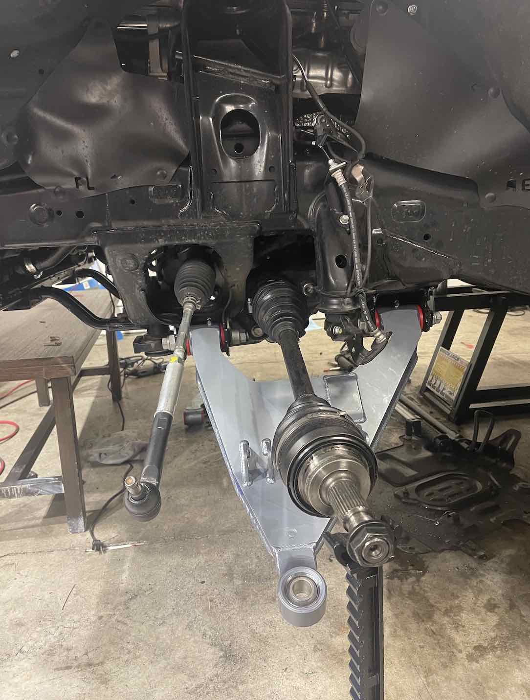

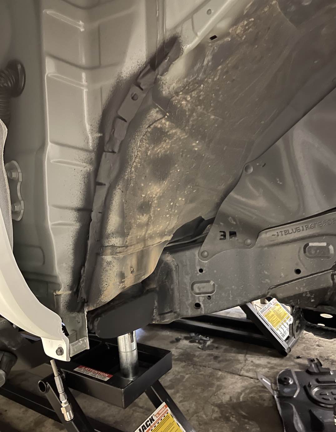

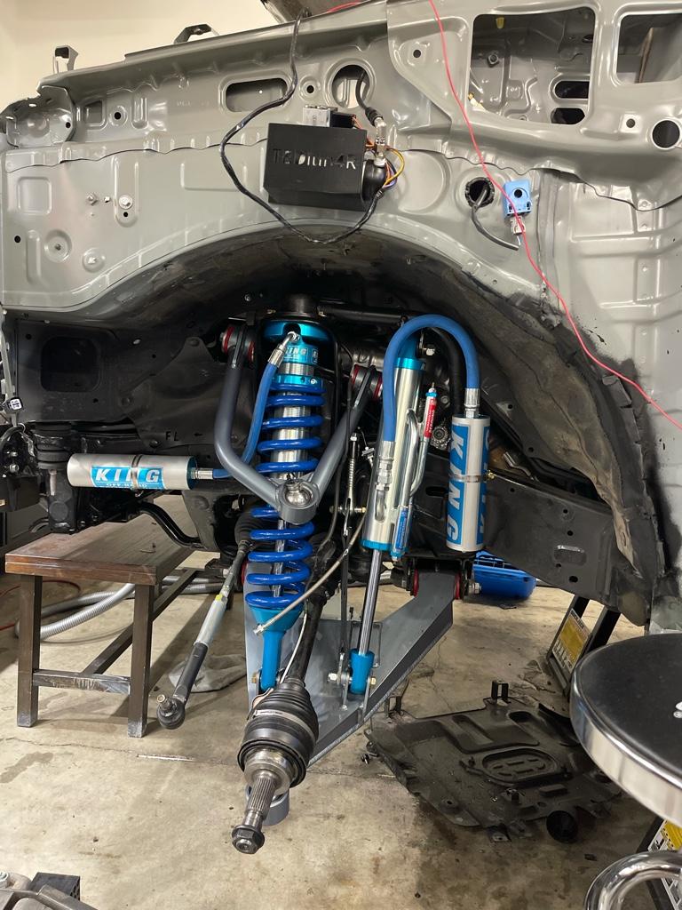

I currently have the drivers side suspension 90% completed. All of the welding for the spindles as well as the drivers side front weld on components are done. Overall I am very pleases with the Total Chaos kit. It is easy enough to assemble and up to this point, everything has fit very well. The bolt holes are all a little tight but a little grease and an impact ran them right through. I have photos of the current sate of the suspension below.
