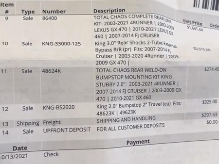

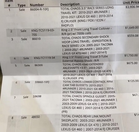

I placed a substantial order from Total Chaos for a front & rear long travel suspension system 3.5+ Race Series w/ long travel king bypass shocks front & rear & long travel king coil-overs. I will upload the parts list for it shortly.

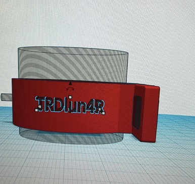

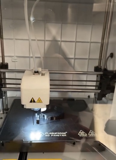

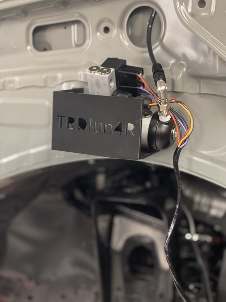

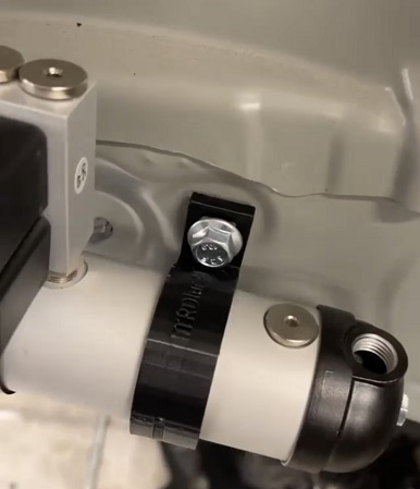

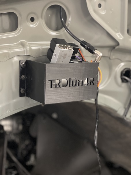

Over the last week I have added in an ARB manifold into the onboard air system and the ARB bluetooth pressure switch. The manifold serves a few purposes, it allows air to cool before entering the abs air lines to prevent melting or overheating. It also will serve as an air storage device for ARB air lockers when it comes time to do the install of air lockers. I have very limited space in my engine bay, so I opted to place the manifold on the exterior of the drive side fender well. In order to mount and protect the manifold I 3D printed a custom bracket as well as a shield to keep rocks and most road grime away from the solenoids for the pressure valve.
(Pics of that are attached)

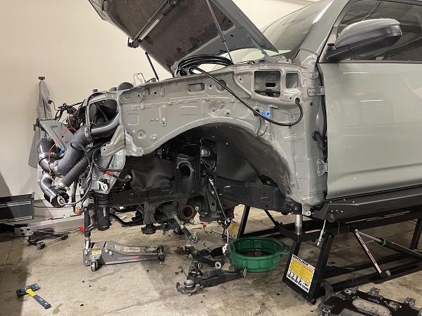

I finished up hammering out the pinch welds and cutting the fender mounts down to clear the 35" trail grapplers this week. I also cut the body mounts for the total chaos BMC plates. I welded the new plates in and ground it down to look smooth and clean. Shot it with some rustoleum protective black paint and I am very happy with the results.
I will add pictures in a day or two when I make it back to the shop.
