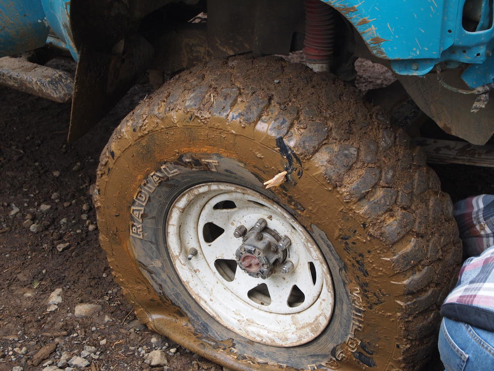

My father wishes he had not stuck with the 15" wheels on his rock crawler sometimes. He can get some crazy float but it's a lot of rubber when your out in the PNW exposed to sticks and logs...

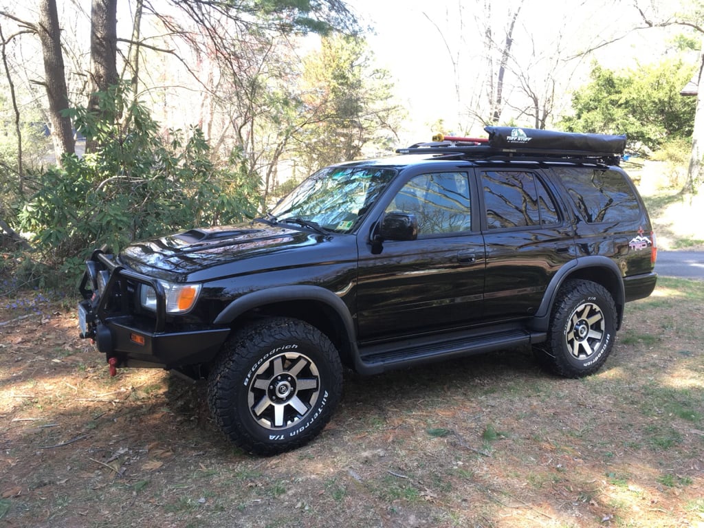

Running 275 70 17 BFG ATs on these Trail wheels. Handles beautifully on and off road. If you are going to wheel hard enough that the 1” difference matters then you prolly need beadlocks
anyhow.
