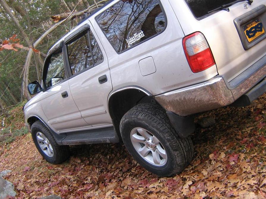

Stay with 265-70R17 with 99 talls.
That was my set up back in 2014 with 05 Sport wheels. No rubbing.
