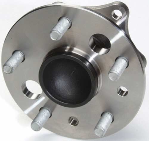

Probably not your issue, but the 2012 Hilux I have here in Afghanistan was rattling like crazy for the past 3 months or so. I took it in for service, twice, and they found nothing... (Typical)
Anyway, it really bugged me, so on a down day I decided to look into it myself.
The little cap that covers the nut for the front hub assembly thing (behind the centercap of the wheel) was not connected. It was just sitting inside the centercap. Picked up a nearby rock, bashed it on there, good as new.
Hope your fix is as easy as mine was!
The cap thing I am referencing is the black cover in this photo (yes I realize it's not on a 4Runner).
