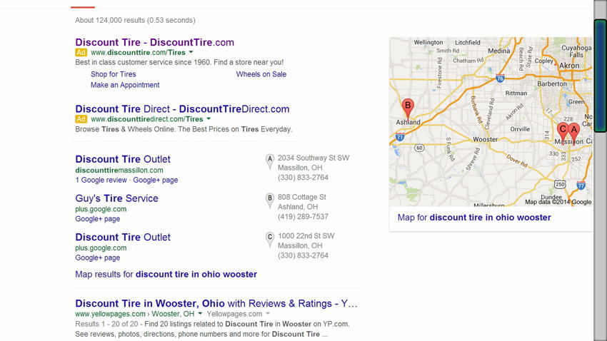

These 3 aren't far and usually have people with common sense working there......
Find the lowest price online or at a local tire shop and they'll match it too.
From google/discount tire/wooster........................
