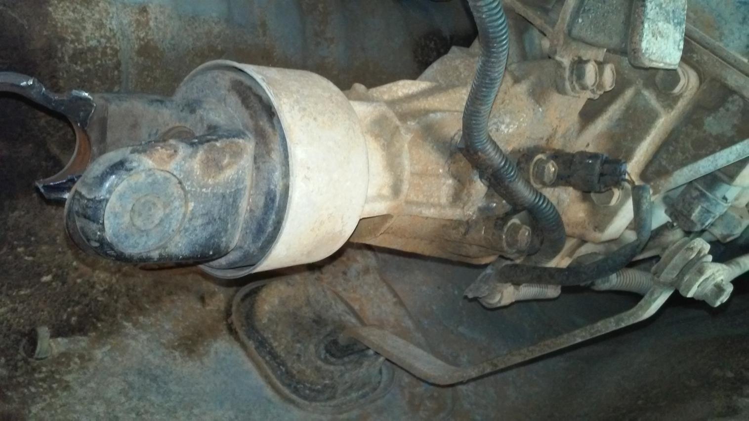

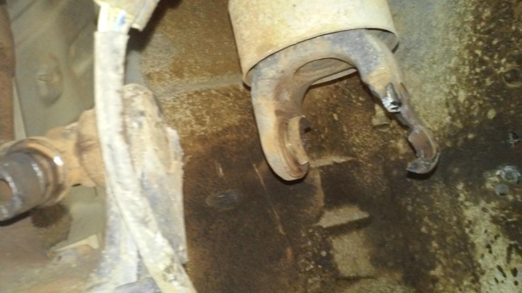

I am replacing my driveshaft in my 97 4runner 2wd AT transmission. I removed the drive shaft from the rear but am having problems with removing the front of the shaft from the transmission. Pic attached

I did reply with one idea but then realized my suggestion wasn't going to work. I'm guessing that broken part of the driveshaft should just slide off the output shaft. If tapping on it with a mallet doesn't loosen it up, I'm wondering if you could somehow get a purchase on it with some kind of slide hammer puller and get it off.
That yoke should just slide in and out of the tail shaft on the transmission?..
Unless I'm missing something?

Yeah I have no idea either it should just come right out. when i try to pull it out it sounds likes its locked on something. its not frozen because when its in neutral it will turn. As previously stated am I as well missing something
I would just tap on it from all sides with a mallet or hammer to see if you can loosen it's purchase on the splines of the output shaft. If that doesn't work, maybe you could use a chisel and a hammer and try to tap it out towards the rear of the vehicle. I wouldn't use a ton of force. It's just really locked onto the splines enough to prevent you from removing it with just arm strength.
Those pics are clearly of the broken axle-end. Do you have pics of the transmission end? It should slide out, and you may just have to pull harder, but the 4wd's have a square flange on that end, and it does need to be unbolted to be removed.

I believe that is the transmission side of it, not the axle. You can see the linkage. My vote goes to getting a snatch strap and wrapping it around the output and tying the other end to the seat post of a mountain bike. Give yourself about 14 feet of slack and pedal as hard as you can. Should yank that sucker right out like a front tooth out of a 7 year old.
Kidding aside, I wonder if the break did something internally that is binding. In theory it should just slide out.
I wonder whether the inner splines are damaged? What made this? This is the first time I see a toyota drive shaft damaged!

That's a strange failure. I'm wondering if the bearing on output shaft on the transmission seized up, and maybe that has the yoke in a bind somehow?
Or, did you move the shifter to P or R?
Anyways the shaft that is stuck in the transmission should come out easily. Go from the engine side and hammer the shaft out towards the rear end.

So OP, did you try what [MENTION=85046]nissanh[/MENTION] and I suggested trying, tapping the sleeve yoke out towards the rear end?
I'm guessing from the look of that break it is seized up on the splines, took a lot of force to break that like that.
