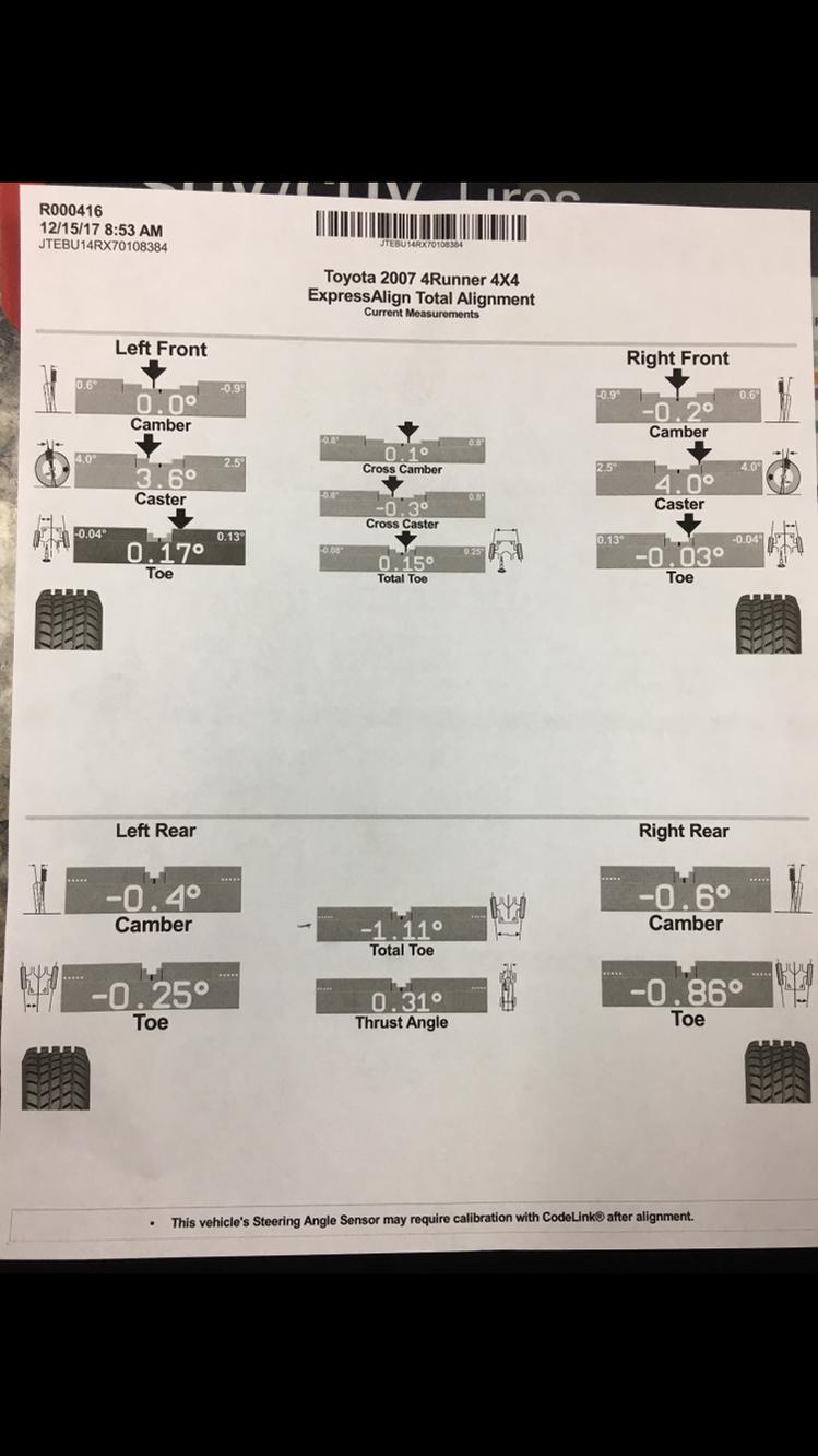

Im currently having trouble with my rear alignment. Below I attached my recent alignment sheet and you'll see that my rear specs are way off. The shop I usually do my servicing says its bc of a bent rear axle housing, to get a second opinion I took it to the toyota dealership. They did a physical inspection and said it does not look bent and also said its not unusual for the age and lift of a the vehicle to be the reason of bad thrust in the rear alignment. So now i'm at a cross roads because something is def wrong my my 4runner and still trying to figure out what to do because my tires are almost worn out just after buying them two years ago and want to get it right before I throw on a new set. Any help would be greatly appreciated!

I'd say something isn't right. It's a solid axle. There should be almost no variation with toe, camber, or caster on the rear.
