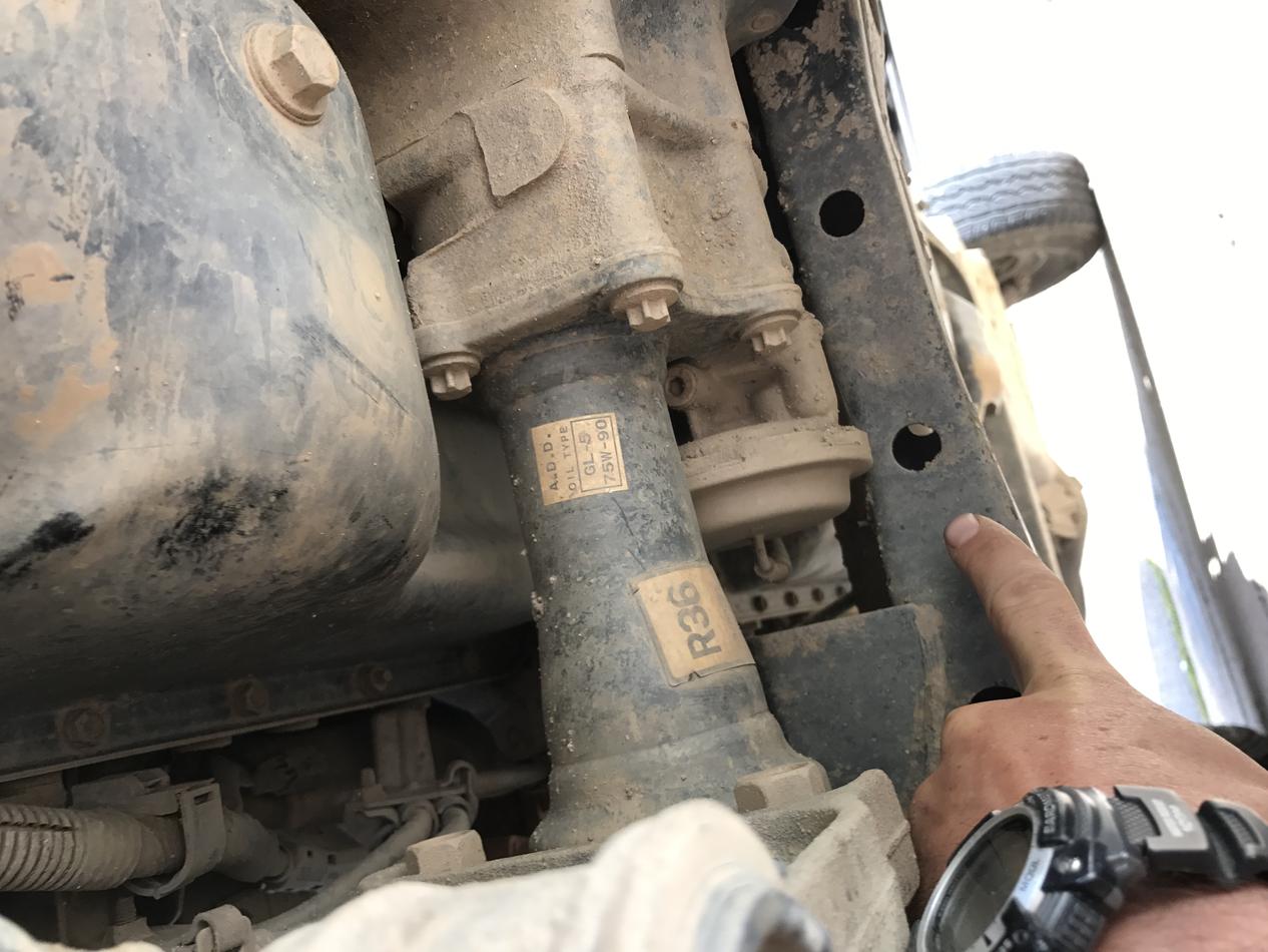

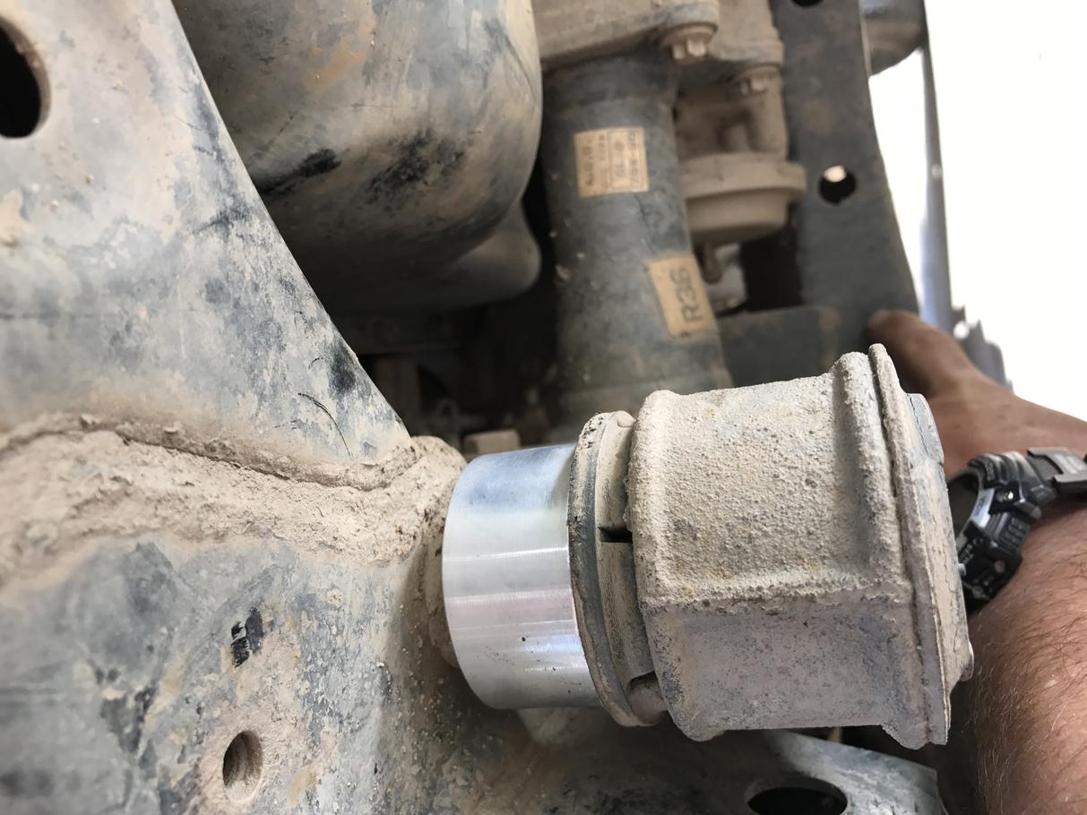

I can get the spacers in, they just don't line up with the holes going into the frame. Looks like the rear of the diff is hitting the crossmember that sits below it. Would the fact that I'm not parked level effect that? Parked in my driveway and it is no where near level ground. Should I do the rear lift and then try again?
Here are some pics I took. Showing where it's touching the crossmember. Cross member has no stress marks, dents, creases or anything that would tell me it's bent or pushed up. I was able to get the spacers in but my holes going up thru the frame are 1/2" or so away

Something is definitely not adding up. I've installed diff drops on two different rigs now, a 3rd Gen 4runner and a 1st Gen Tacoma and it was very easy. Have you checked the condition of the rear mount for the front differential. The rear mount has a stud that drops into the cross member and is held tight with an allen head nut. Maybe that mount has deteriorated or the nut came lose allowing movement in the differential that shouldn't be happening.

same thing happened to me with the SS diff drop. I called Steve during the process, and sent him the same pictures. He told me based on the year it's a crapshoot whether they used pre-face lift cross members vs. post face-lift cross members (or something like that).
anyway, my solution involved a large pry bar and some muscle, but I managed to finally wedge it in there. You just REALLY have to pry that ish up hard.

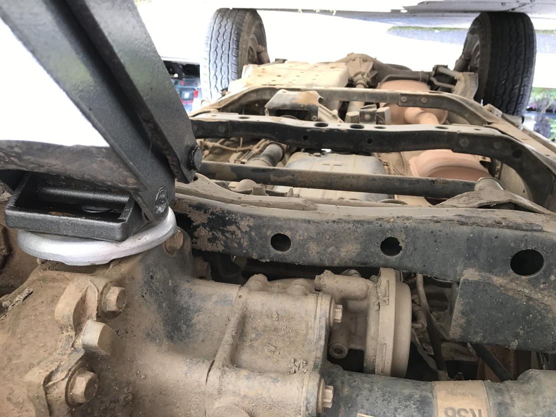

Here is a picture of how much room I have with 2 1/4 inch diff drop
I can take more pictures if you need, we will get that dang drop in!!

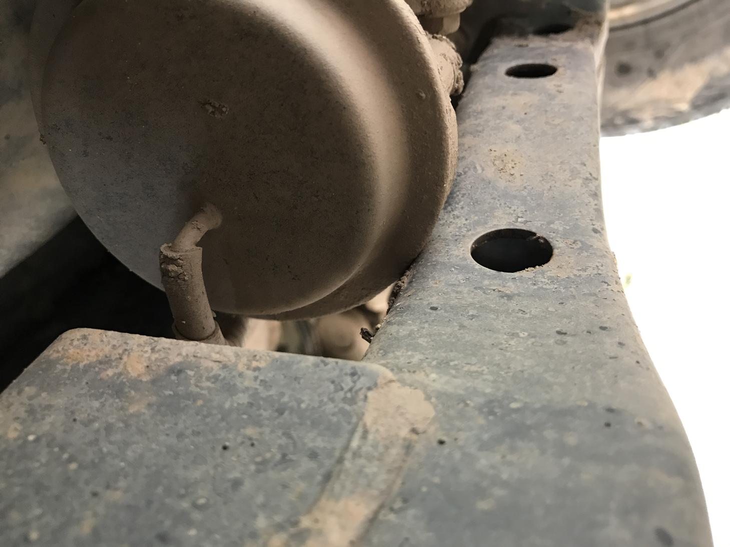

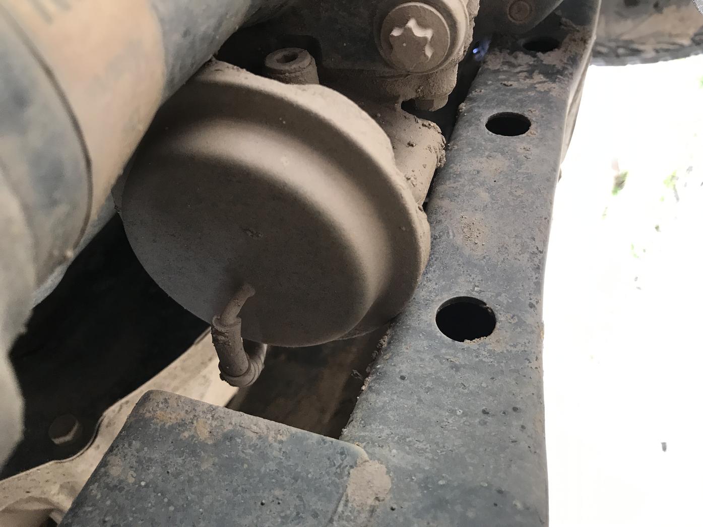

So it's looking like the round thing is the culprit. Looks like a regulator to me but idk what it is. It's actually touching the frame now and won't let me push the diff towards the rear that little amount to line up my holes.
**Pictures show the right being the ground/down**

Tried again, just as the rain started coming, and was able to get it in. A bit of force and starting on the driver side I was able to get it in. Still looks like the disc part is touching the frame, but since they move as one I'm sure it won't be a problem.

Like I said before, it's like yours is different... Running more than 3 inches of diff drop would be near impossible for me, bending it to 3 is pretty hard but would be pretty easy for me because of the tools I have. I just didn't need that much though, don't want to increase the chances of smashing it either.

That round piece is the vacuum actuator for front diff, no worky no 4wd. What is the condition of the rubber bushing mounts for front diff? There are 3, two at front where you put the drop kit, one at the rear of diff. If you leave it like it is I see problems in your future. I've installed a few 1" drop kits all had no interference with crossmember but close.
