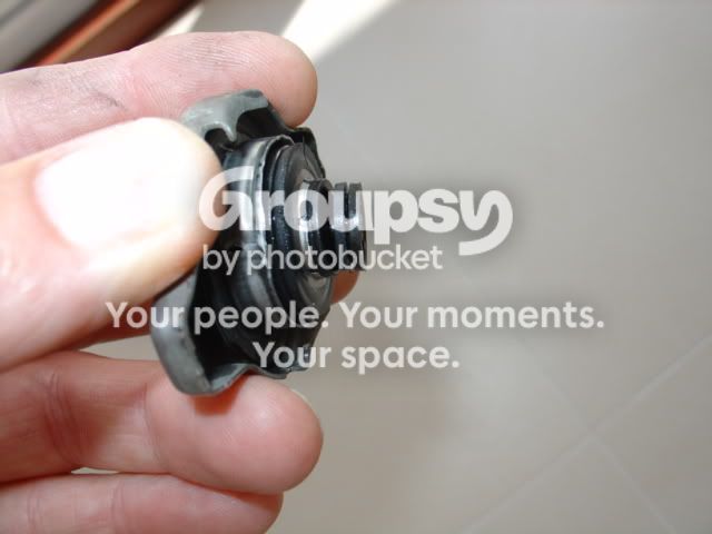

The pic below is not mine, but it looks the same. What is the purpose of those 2 disks at the bottom? On my old cap, they dangle pretty free, on the new cap, they dont move much. So is this why its bad?
